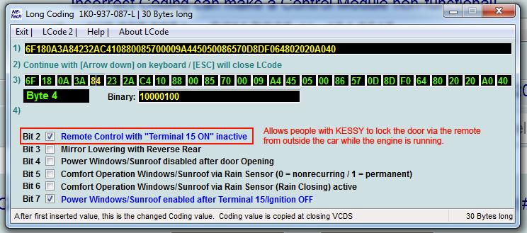

  • Anyone enabled this...lock car with engine running...
    KESSY: Lock Car While Running
    Description: this allows you to to start your car with KESSY, then get out with the key, and lock the car with the remote
    Check bit 2 of byte 4 in Central Electronics Long Coding Helper

          • Originally posted by sVWatt View Post
            sVWatt: I think that you might be referring to the older version Golf - perhaps this:
            For the mk7, this function is enabled via an adaptation channel change as follows:
            1. For older BCMs, IDE05142-ENG115754-Access control-Funk bei Klemme 15 ein > active
            2. For newer BCMs ENG141651-ENG115754-ZV allgemein-Funk bei Klemme 15 ein > active
            Of course, you will need to use the venerable magic number 31347
            Don

              Hi Don
              I was adventurous and nailed this one by myself last week.
              You are right though, the setting change enables the key to work inside the car and outside the car with the engine running.
