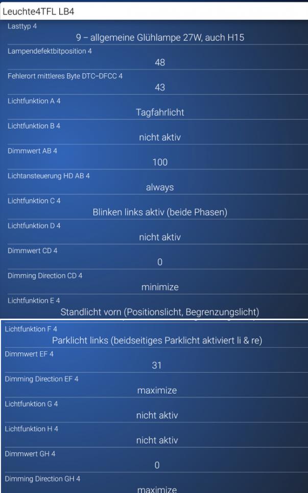

                  • Hey All, I picked up some new LED headlights from Supernova to replace my halogens, Ive just noticed when the low beams are on. the 2 DLR U's dim. which is fine. Though on the passenger side, one DLR dims the other goes out, I asked someone else that I knew that had them he said his would flicker abit as the voltage they receive is low when dimmed and to up the brightness a little so they dont flicker or completly turn off. He doesnt have access to his tablet to see what changes he made, any ideas?
                    • What im aiming for is. When DRL are on in the day, they are nice and bright (currently doing this) When indicating in the day, DRL turns off for that side (currently doing this) When low beams on, DRLs on Dim (currently doing this but not bright enough to trigger one of the LED U's to turn on) When low beams on and im indicating, DRL turns off (Not currently doing this)
                      • ^^^ Jozh: G'Day! It's always difficult when responding to questions about aftermarket stuff because the available products and their impact on the car varies so greatly! So, I'm really guessing but here's my logic:
                        If your car originally had incandescent headlights and if you just did a physical install with LED fittings, then likely the BCM (Body Control Module - the thing that lives @ address hex09 on your CAN bus) still believes that it needs to operate incandescent DRLs. Of course this is an abject lie because the BCM should be controlling LED lamps!
                        I'm not sure if you are aware (forgive my impudence if you already know this stuff), but the BCM on a mk7 is quite a sophisticated beast - it has the facility to operate lamps both in digital and in decimal mode. The latter approach is normally used for incandescent lamps and the former is normally used for LEDs.
                        So - totally as a guess, why not try telling the BCM to operate LED type DRLs? If you agree, then try this:
                        • ENG116940-ENG115948-Leuchte4TFL LB4-Lasttyp 4 (left-side DRL)
                        • ENG116941-ENG115967-Leuchte5 TFL RB32-Lasttyp 5 (right-side DRL)
                        These are the "leuchte-channels" that tell the BCM what type of DRL lamps it needs to control. If my guess is correct, the current settings on your car will be 9 - allgemeine Glühlampe 27W; auch H15
                        Try changing the settings for these channels to 1 - LED Tagfahrlichtmodul Versorgung (of course you will need to enter the magic number 31347 as the security code for the BCM before you make the change)
                        Don

                              Thanks Don, ill give this a go when I get a chance Correct car had halogens, the new headlights can take halogen or led for the lowbeams. the DRL are leds. VW Golf MK7 - Sequential Projector Headlights - Supernova Lighting If I dont have any luck with changing to LED, what else can I try? These are the current settings:
                              • No luck with setting to led.
