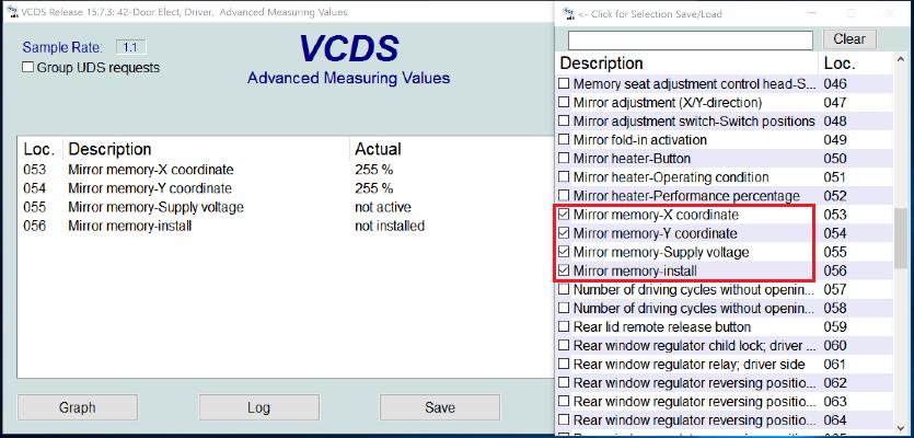

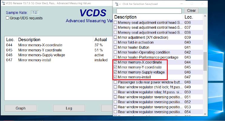

                • Originally posted by DV52 View Post
                  It's relatively easy to find-out if your passenger-side door control module is fitted with a memory module to facilitate reverse dip as follows:
                  1. Select the control module at address hex52 and then select Advance Measurement.
                  2. Click the boxes for the variables shown on the right-side of the screenshot below and if your car is fitted with a memory module, you should see the values in the left-side of the screenshot below. (Note: the "X" and "Y" coordinates may differ - but the values can't be 255 (which is HexFF) and 046 and 047 MUST be as shown)
                  If your car isn't fitted with a memory module, the results of the Advanced measurement should be as below (which is the result for the driver's side door control module on my car)
                  Don

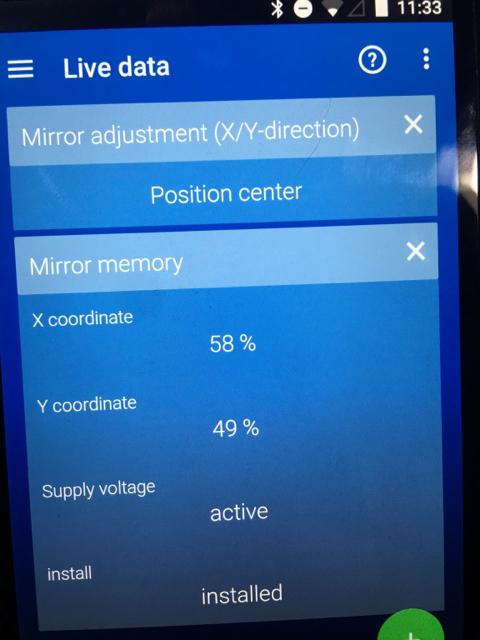

                  I've got a MY16 and I leave the mirror control knob on L, and it seems I have the hardware installed in OBDeleven. Is the passenger mirror supposed to dip as soon as I put her in reverse? I swear that isn't happening but I'll stare at it in the morning [emoji3]
                  • Originally posted by isaacinsoll View Post
                    You actually need to set the mirror to the position you want it to dip to.
                    Follow these steps:
                    1. Set knob back to 0
                    2. Put car in reverse.
                    3. Set knob to L
                    4. Adjust mirror to the dipped position you want.
                    5. Test this has worked by turning the knob back to 0, the mirror should return to driving position.
                    6. Turn the knob back to L, the mirror should dip to your set position again.
                    If you leave the knob on L, the mirror will stay dipped for a little while when you go from R to D. It will return to normal position after you drive forward for a bit. It will automatically go to dipped position the moment you go to R.

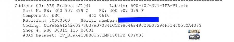

                      • Hello =) Need some help. Does any have coding of ESP from MY16 with 3Q0907379 unit? =)
                        • Originally posted by zloybob View Post
                          My coding unit ABS/ESP after Retrofit 5Q0 to 3Q0
                          Regards
                          • zloybob
                            Information from my database below
                            Don
