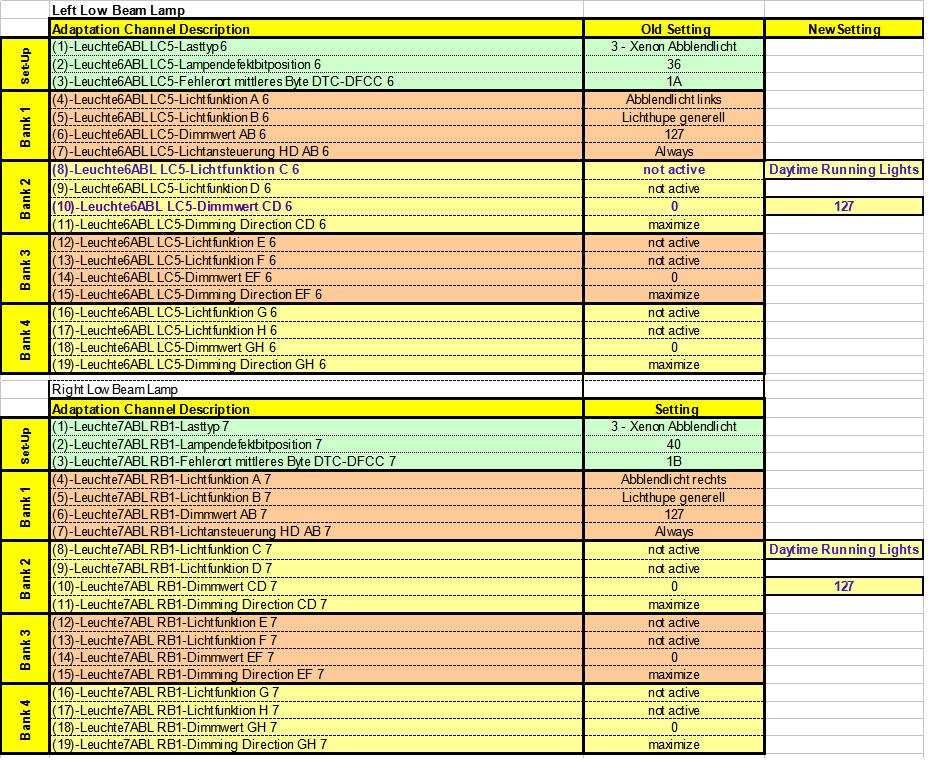

      Hi guys. I have been struggling to find out how to set my low beams to stay active during daylight on my GTE. I don't want the DRL lights so I need the low beam to stay on at all times on my car. I have tried the following:
      09-Central Electronics > Adaptation-10
      (5)-Leuchte6ABL LC5-Lichtfunktion B 6
      Value: Daytime running lights
      Stock: Lichthupe generell
      (6)-Leuchte7ABL RB1-Lichtfunktion B 7
      Since I don't know what "Lichthupe generell" does I replaced it with Daytime running lights. I did this during daylight to see the difference and it was working all fine. The issue happened the next day, when I checked I had no low beams, they were only working when it was dark. So I guess there is an issue with the dimming (I read "Lichthupe generell" had something to do with dimming).
      I know I can control this from the switch, but I like to have mine in "Auto" position because the car is equipped with the high beam assistant.
      Can anyone please help me with this?
      Thanks in advance

        Drive: Hello. It seems odd to want to have the low beams continuously turned-on, but I have to admit, that my knowledge of the day-time environment in Oslo is very poor!
        Anyhow, my suggestion is that you return the changes that you made back to the original settings ( see values below) and try the changes in my table below. Please note that there are changes required to channels (8 ) and (10) in the left and right lamps. Also note that I have not tested these changes - please provide feedback when (if) you try them.
        Cheers
        Don

        • Cheers Don! What is bugging me is the crappy light sensor which is oversensitive. It goes nuts at times. I can see that on the navigation screen that it switches back and forth between day and night mode. Also I gotta admit that I'm slightly tired of the e-Golf look as we have sooo many in Norway...
          I have already made the changes and I'm looking forward to see how it works. In the meantime I came across the following setting:
          ( 8 )-Daytime running lights-Fahrlicht bei Tag,Daytime running lights
          I'm not sure what kind of options I have on this one but maybe I can solve the puzzle with this one setting.
          Thanks a lot for your help

            Drive: Yes, changing the setting for ( 8 )-Daytime running lights-Fahrlicht bei Tag,Daytime running lights from "daytime running lights" to "low beam" will work, but it will disable the normal DRLs (i.e. this channel is either/or). I had assumed that you want to keep the normal DRLs illuminated AS WELL AS the low beams
            Don

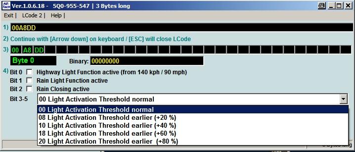

            PS: In respect of your "crappy light sensor", you could check the coding on the RLS/RLHS/RHFS (which is a slave module to the BCM). The pertinent Byte is hex0 (see picture below) - is your coding for Bits 3-5 hex00? You could also check the setting in the MENU for turn-on threshold
              Yes I want to disable the DRLs totally and just use the low beam so I will assume this simple setting will work. Regarding the Light Activation Threshold, I need to check that. As you said there is an option in the MENU (Early-Medium-Late) so is this something in addition to that or are you basically toggling the same setting with this hex?
              Example: If I set mine to Early in the MENU, and set this one to +80% earlier, does that mean really really early?
              2016 MK7 Golf GTE
              • Originally posted by Drive View Post
                Drive: OK. My assumption (about you wanting both DRLs and low-beam operating together) was predicated on your first post where added DRLs to the low-beams -without removing the DRL settings from the 2 x Leutche sets. But if you just want to substitute the Low beams, then the simpler tweak is better!
                As for your question about the RLS/RLHS/RLHS, the settings for Byte 0, Bits 3-5 are stand-alone and are not affected by the value in the MENU. The way I think about this facility is that settings in Bits3-5 create the reference threshold around which the MENU values operate. So, the absolute latest light threshold is Bits 3-5 set to Hex00 and the Menu value set at "late", and the absolute earliest light threshold is Bits 3-5 set to hex20 and the Menu value set at "early" (hope this makes sense)
                Don

                  Don: I wanted to confirm that this does not work. Low beams won't turn on during day in Auto.
                  2016 MK7 Golf GTE
                    Drive: thanks for the feedback. If I had HIDs on my mk7, I would try some alternative remedies, but since you have an alternative method, I'll leave it
                    Don

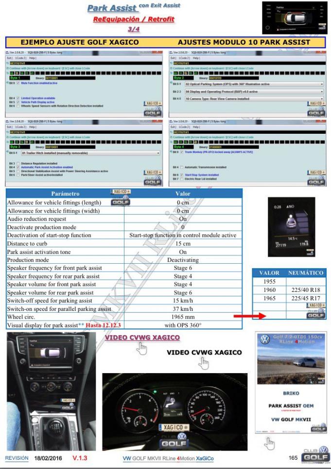

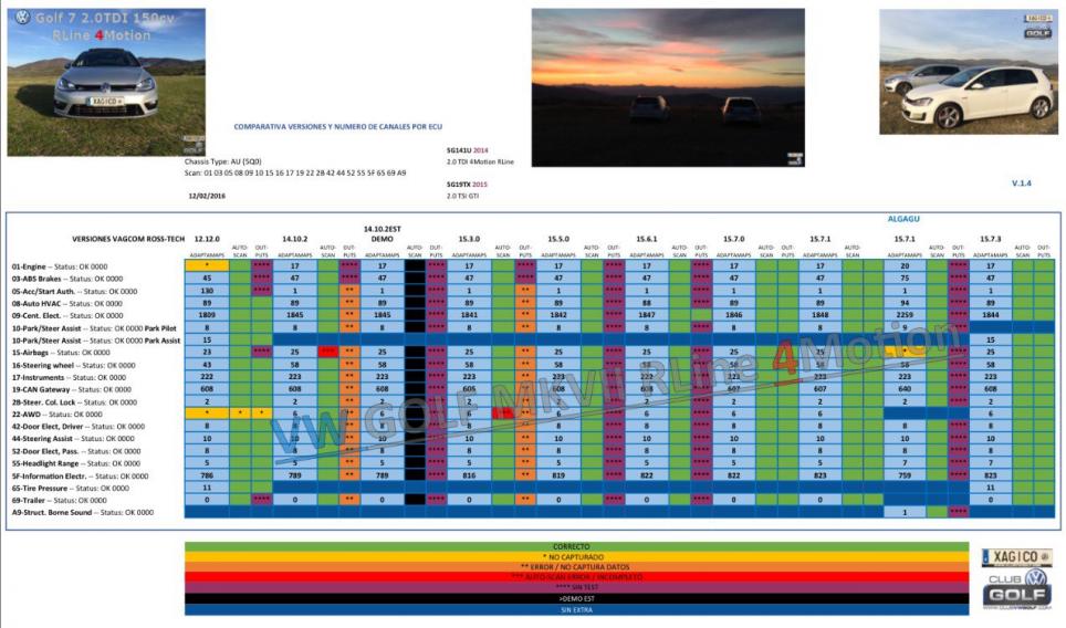

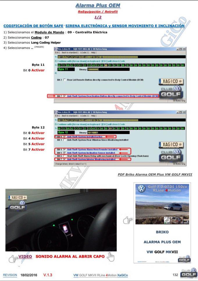

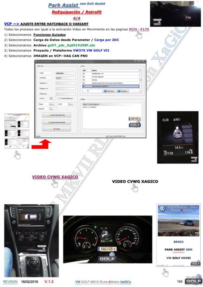

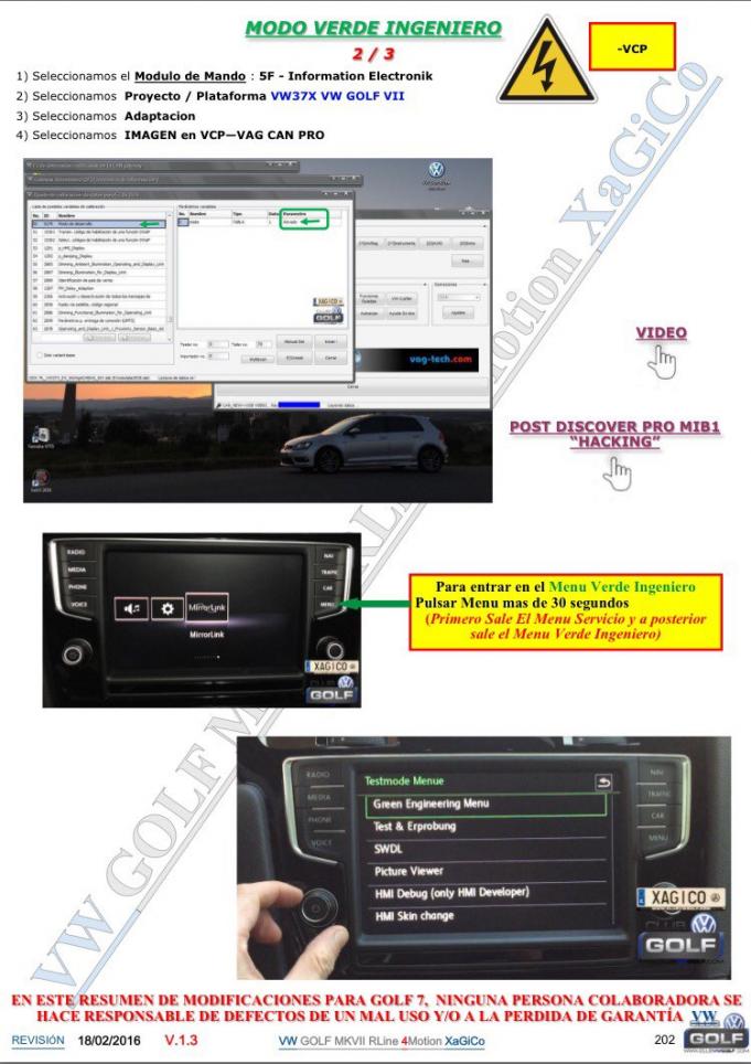

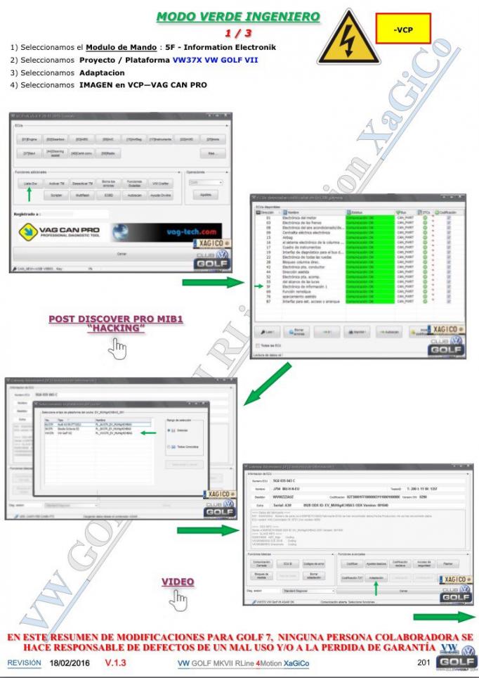

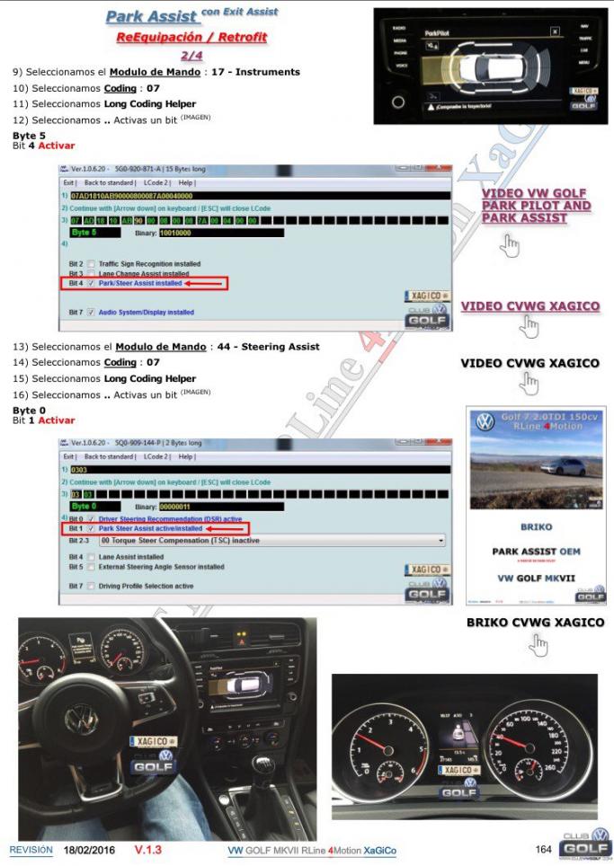

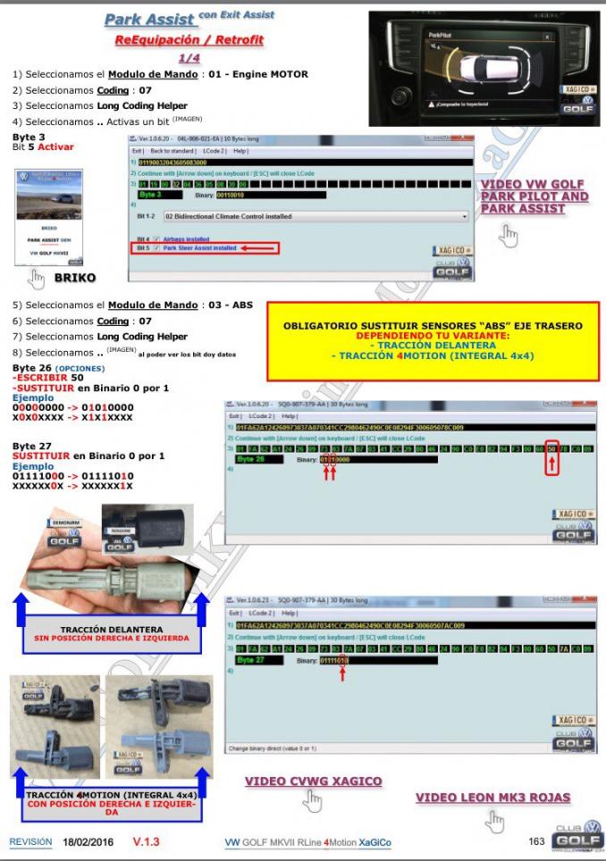

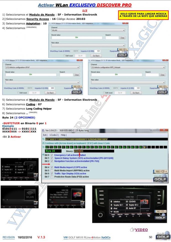

                    • VCDS (VAG-COM) codes and programmable options for Golf Mk7
                      UPDATE TUTORIAL MODS VW GOLF MKVII v.1.3
                      In Spanish!!
                      News v.1.3 :
                      Sorry, we couldn’t find that page
                      Link Updated - > PDF DOSSIERS MODIFICACIONES PARA VW GOLF MKVII
                      Versión v.1.3 18-02-2016
                      Size + 111MB
                      Numbers of pages 216
                      Controller Channel Map (Mapas de Adaptación) y Auto-Scan en varias versiones de Vag-Com en el VW GOLF's MKVII de @XaGiCo y @Algagu
                      New Data 10 , 65 y VAGCOM 15.7.3
                      Link Updated
                      NeXT Toturial Park Assist Retrofit sin e Park Pilot ....
                      Link Club VW Golf España -> VCDS/VCP MKVII
                      Enjoy It!![emoji851][emoji851][emoji851]
                      Good Day / Night!!
                      Regards!!
                      Club VW Golf España
                      XaGiCo
