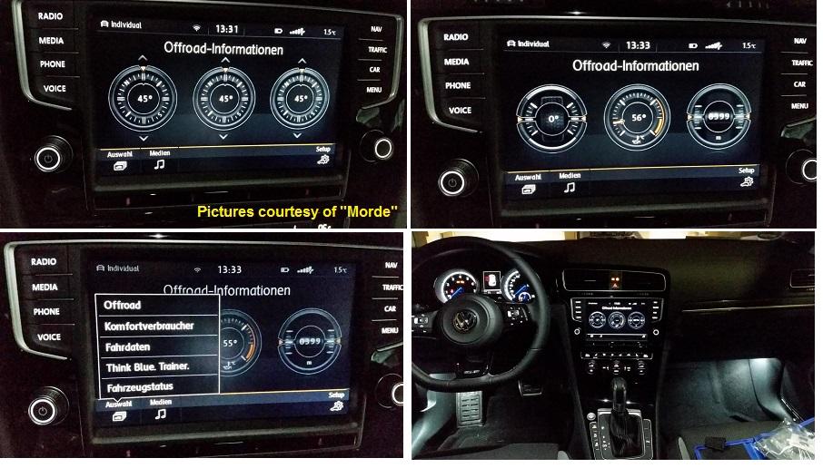

          • MIBII - Activate Off Road Display
            Here's another tweak from our forum colleague Morde. I don't have an MIBII fitted to my car, so I can't try these instructions, but I'd welcome feedback from anyone who completes the tweak.
            Morde says that after implementing this tweak, the screens shots below should be accessible on the infotainment unit:
            Off Road Display - Instructions:
            WARNING: VCDS users that have a HEX+CAN, or Micro CAN Cable please note that this tweak (and any tweaks) on MIBII units (address Hex5F) should only be implemented with Ross Tech software version 15.7.3 (or later).
            REQUIREMENT: This tweak will only work on MIBII units that have SATNAV installed (don't bother trying if a SATNAV is not present).
            Step 1. On Select Control Module screen click "Select"
            Step 2. Select 5F-information Elect
            Step 3.
            Go to step 4 - Note: I've had reports from some forum colleagues that a security code was needed. If the adaptation channel settings in Step 5 are locked:
            Step 3A. Go back to the Open Controller screen and select Security Access-16
            Step 3B. Enter the magic number 20103
            Step 4. Select Adaptation-10
            Step 5. Change the following adaptation channels:
            • (81)-Car_Function_Adaptations_Gen2-menu_display_compass - set to active (default not active)
            • (83)-Car_Function_Adaptations_Gen2-menu_display_compass_over_threshold_high - set to active (default not active)
            • (41)-Car_Function_List_BAP_Gen2-compass_0x15 - set to active (default not active)
            Exit the Ross Tech software
            Step 6. Reset the MIB unit - press and hold the ON/OFF button on the infotainment unit until it turns-OFF and then turns-ON again.
            • I have just activated this (off road display) appears to be working well, much the same as the set up I had in my Touareg.
              To access the dials shown on the above top right pictures you need to swipe the dials up or down. By default they only display the compass. I have elevation, compass and tyre direction displayed but there is also oil and water temp.

              • Originally posted by Flipper Dog View Post
                Didn't have time to go through all the programs but the Adaptation 10 have some interesting stuff to play around with on the MIBII.
                Flipper Dog - Many thanks for the quick feedback and the additional instructions. Great to hear that the tweak went well. I've been looking at the range of adaptation channels in the new MIBII out of general interest (I don't have a MIBII) and I agree that there are some very intriguing channel descriptors in the control module.

                • Originally posted by DV52 View Post
                  Neat little tweak. It's working on my NAR MY16 7R with Discover Pro. Thanks!
                  • Thanks DV52 and Morde.
                    coding works fine, i tried to activate the SportHMI 261, 263 as per a Seat and nothing happen on the MIB2, i activated all of the SportHMI options and still nothing,pretty sure it needs something activated in the Car_Function_List as well just like the off road display.
                    "Forced induction" sounds like some sort of sexual assault.
                    i drive a Golf 7R tuned by APR + exoticars
                    • It works perfectly with my GTI, it is super awesome tweak. hopefully we can enable the performance monitor gauge. Thanks for your contribution DV52!! You are awesome

                        @tuzii and elastica_junky:
                        For activation of the performance monitor (SportHMI) we need an update/security key from VW. It is not possible to enable it only with coding ("Software as Product" (SWaP)). With this key your dealer can activate the performance meter. For now (in Germany), it is not possible to activate it but VW released the new Volkswagen MK7 GTI "Clubsport" about 3 weeks ago. You can order the clubsport since 2 weeks. (Volkswagen Konfigurator - jetzt Wunschmodell konfigurieren) The new GTI should have the performance monitor by default. I think we have to wait until the GTI finally arrives at the customer. Then it's just a matter of time until "normal" GTI or R models can activate it.
                        @all please feel free to ask me, if you have questions
