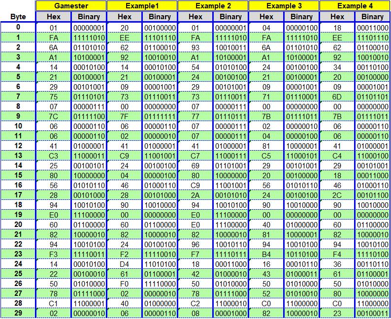

            I had changed my ABS from 29 bytes 5Q0907379AC to 3Q0907379AB
            my old ABS coding
            01FA6AA120211275037C060601C32980560448C0608094F3142A5038C1
            my new ABS coding
            01FA6AA114212975077C060641C32580562894E0608294F314225078C102
            But i think it is not fully correct
            at least Brakes specified incorrectly in byte 4 and 14.
            I think the correct values are 24 in byte 4 and 29 in byte 14. But ABS did not accept such changes.
            is there any one who could help me with proper coding?
            My car is VW golf 7, 1.4TSI 140Hp, DSG7. Front brakes are 288mm, rear brakes 272 mm.
            • Gamester- not sure this helps:
              Example 1
              System description: ESC
              Software number: 3Q0907379AB
              Software version: 0723
              Hardware number: 3Q0907379G
              Hardware version: H42
              Serial number: 62615000000403
              ODX name: EV_Brake1UDSContiMK100IPB
              Long coding: 20EE629214210973007F060241C9240446289000608224F2D4 61F0024006
              Example 2
              Serial number: 62685000001022
              Long coding: 01FA93A1542429730777070741C76980C92A94E0E08296F718 425078C208
              Example 3
              Serial number: 62115000000629
              ODX version: 034036
              Long coding: 04FA6AA124210971007B020481C5292056249000408194B416 435052C082
              Example 4
              Adressword : 03 (Bremsenelektronik} - J104 ESC
              VAG Nr. SW: 3Q0907379AB HW: 3Q0907379G
              SW Version 0723
              # Codierung 18EE62923420096D007B060641C42918462C9000608294F436 615080C023
              And the comparison looks like this:
              Don
              • Originally posted by DV52 View Post
                Don
                Thanks!
                Can you specify Car, engine and transmission?
                Also I think that coding is similar for all H42 ABS and may be even similar to H31. Probably you have other H42 ABS coding.
                As I know byte0 is define car type.
                01 - VW Golf 7
                04 - VW Golf 7 Variant
                1A - Skoda Octavia A7
                1D - Skoda Superb III
                Byte4 is a front brakes:
                14 - 270 mm
                24- 288 mm
                34 - 312 mm
                54 - 340 mm
                Byte14 is rear brakes:
                25 - 253 mm
                29 - 272 mm
                68 - 310 mm
                Byte17 is main brakes cylinder
                24 - for cars <=110 kWt
                28 - for cars 1.2TSI
                2C - 135/155 kWt
                2A - >168 kWt
                Bytes 5,7,9,11,13 is calculated from VIN and can be taken from old ABS coding.
                here is calculator to calculate this bytes from VIN
                Vagflash
