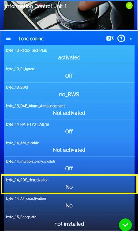

                        TMC is done like this:
                        But you need to make sure that the RDS (Radio Data Service) is enabled on the car. I'm not sure if this is factory set by VW on a mk7.5 - some new model Tiggys don't have this enabled as default. So you have select coding in the second screen above and check this:
                        You need to check that the entry byte_14_RDS-deactivation is set to No and also (not highlighted in the picture above), make sure that byte13_Radio_Text_Plus is set to Activated
                        After you make these changes, I've sometimes found that a reset of the MIB unit is necessary (press and hold down the ON/OFF button until the MIB turns-off, then turns-on again)

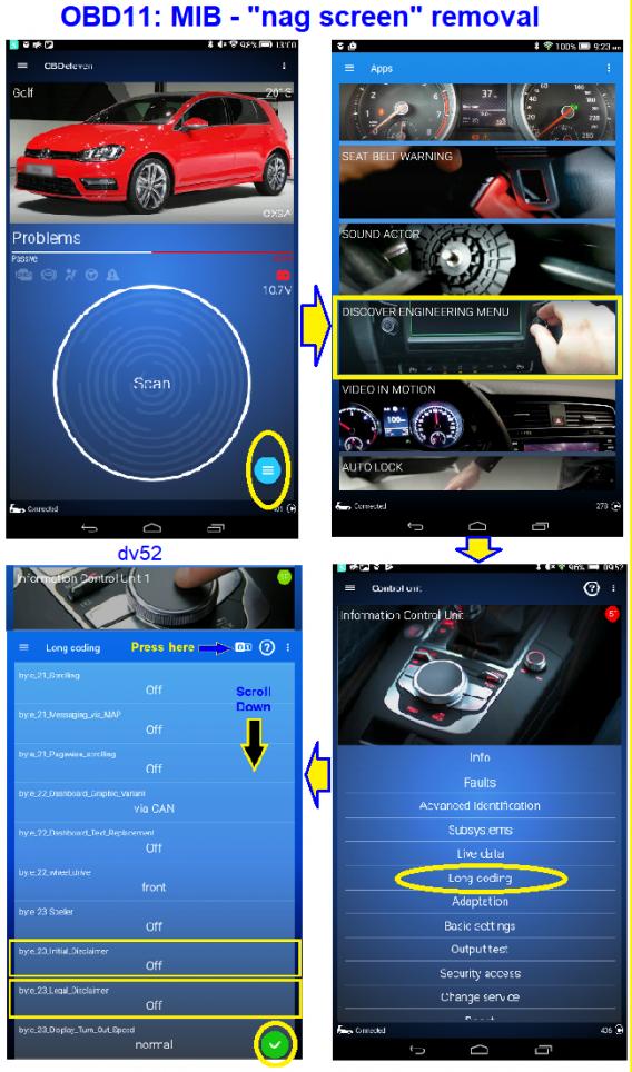

                        For the nag screen delete, do this:
                        Don

                            • I've tried (unsuccessfully) to get rid of the nag screen using VCDS (Ross-Tech V 18.1) but the info provided on this website about doing this process seems to be a bit old or maybe I'm just a bit dim? I am a newbie to this stuff but I have tried to follow the instructions and I don't see exactly the screens as provided. I don't have OBD2. I know it's boring but I have tried to find a clear explanation but have come up short. Is there anyone who could provide some screen shots of the process using the latest version. I have a 7.5R.
                              Wolfsburg 7.5R. Lapiz Blue hatch DSG with sunroof.
                              • Originally posted by iant333 View Post
                                You cant rid of the screen as it is not fusion mode which is impossible to do with our maps for TSR
                                Sent from my SM-G935F using Tapatalk
