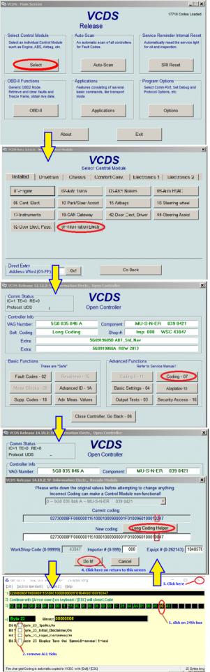

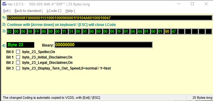

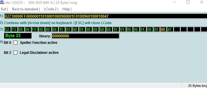

              • Originally posted by iant333 View Post
                I've tried (unsuccessfully) to get rid of the nag screen using VCDS (Ross-Tech V 18.1) but the info provided on this website about doing this process seems to be a bit old or maybe I'm just a bit dim? I am a newbie to this stuff but I have tried to follow the instructions and I don't see exactly the screens as provided. I don't have OBD2. I know it's boring but I have tried to find a clear explanation but have come up short. Is there anyone who could provide some screen shots of the process using the latest version. I have a 7.5R.
                iant: If you are using a HEX+CAN cable (the older product), the "normal" long coding helper screen for Byte 23 on the 5F module looks like this:
                Or, if you are using one of the HEX- V2/NET cable/dongles, the "yellow" long coding helper screen looks like this:
                regardless of which screen you access - simply set the value of Byte 23 to hex00 (or Binary 00000000)
                Don
                PS: If you are using a HEX+CAN cable on your mk7.5, I suggest that you upgrade to a HEX-V2/NET series devices. There are modules in this model that use the new OBD 2.0B protocols (29 Bit addressing) that the older cable can't read
                • Beat me to it - but this is it
                  • Thanks for helping, however I feel like a lame novice here. I have a HEX-V2 (Firmware 18.1) I have tried many screens but I can't find the screen as illustrated. Sorry to bother you all again, but please would it be possible for you to briefly outline the menus and steps to take to get to these screens. I've tried and failed.
                    Wolfsburg 7.5R. Lapiz Blue hatch DSG with sunroof.
                      iant: Not a problem - we have ALL been there at some stage in our VCDS learning-curve!!
                      Here's a pictorial instruction that I hope is self explanatory. Please ask questions if further help is needed
                      Note the numbered steps in the last screen - follow the numbers
                      Don
