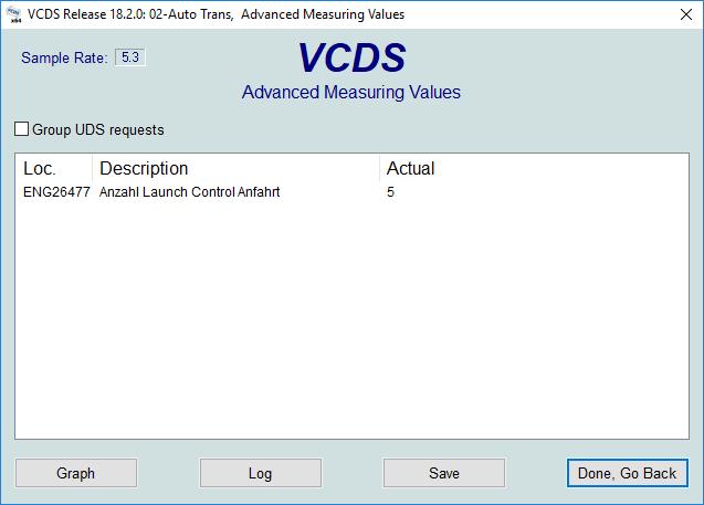

    ^^^ many thanks - seems like later model mk7s do indeed have the counter!
    Don
    Did a few launches over the weekend and can report the counter does indeed increment:
    MY13 Golf GTI DSG (SOLD)| Candy White | 18" Detroits | Bi-Xenon Headlights | Street Guardian SG9665C
    MY18 Golf R DSG | Indium Grey | 19" Spielbergs | DAP | Sunroof | Viofo A119v2 (front) | BlueSkySea B1W (rear)
    Micro-CAN VCDS
    • The happy maximum was 200
      200 Launch Maximum Reached - Launch Control No Longer Functional
      A mate with an S3 said he got an mild grilling at the Audi Centre when he recorded 16 in one year.

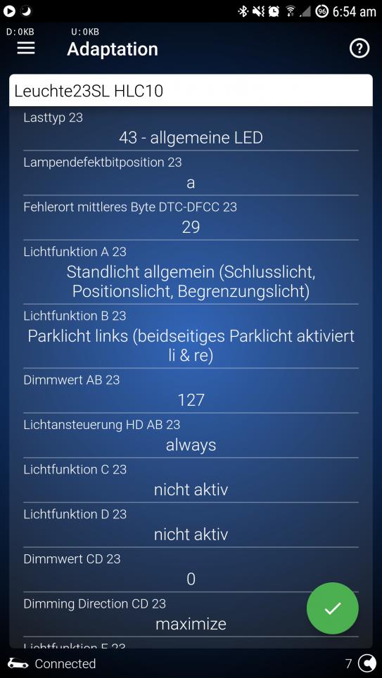

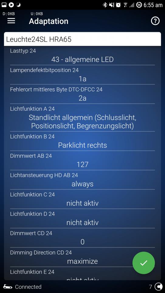

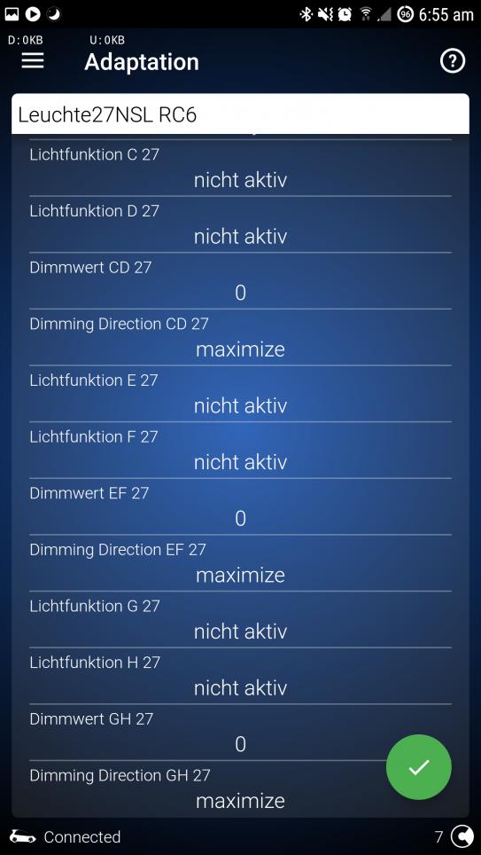

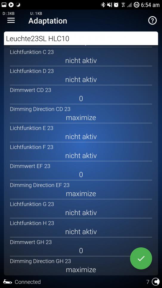

                              • Hi all, I've recently bought a brand new MK7.5 comfortline with DAP and I wanted to implement the 5 brake light mod.
                                I have tried 2 methods (this and that) so far without any luck and I was hoping someone could help me out.
                                My golf has the standard LED tail lights.
                                Below are some screenshots of the current settings in OBD eleven.
                                Thanks for all your hard work guys.
