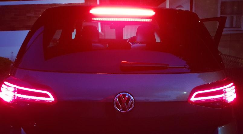

I can't remember which specific adaptation channels I changed; I'll have to go look through my logs. Yes, I have rear LEDs with dynamic turn signals.
Here's what they look like now
I've also coded the outer lights to light up when the hatch is opened, and for the high mount (3rd) brake light to light up when I'm in reverse, to give the reversing camera more illumination.

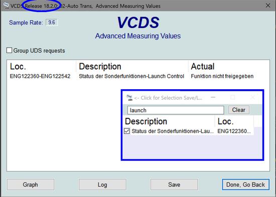

Not sure how many VCDS cable users have downloaded the latest RT software (version 18.2.0), but it's been reported on the RT forum that it's now possible to read launch control numbers on some cars.
I have tried accessing this new feature on my MY13 model and whilst I can now see a form of the Launch Control feature, it's clearly not available on this early version car - see screen shot below:
Can someone with a newer version mk7 please try finding the Launch Control counter on their car - please? The facility is in the transmission module (i.e. Auto Trans module @ address hex02), in Advanced Measuring Values. Just type "launch" into the search box. If it is possible to read launch control numbers on your car, you should get something like this:

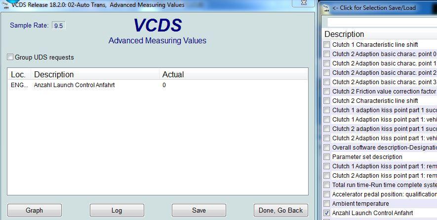

Hi Don,
I downloaded VCDS 18.2.0 and used my Micro-CAN to read my 7.5R. I can see the launch control count as in your above picture, however mine reads 0. Of course, I haven't used launch control yet! In the next few days I should be hitting the magic 1600k on my motor, at which point I'll try a launch or two and see if the counter changes.
I also scanned my MY13 GTI (which I have launched) but the counter does not exist.
^^^ many thanks - seems like later model mk7s do indeed have the counter!
