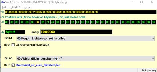

          Sasquatch: hmm.......... bummer - I'm running out of suggestions fast!! One last thing you could try - here is a copy of the new "yellow" long coding helper screen for Byte 6 of the BCM:
          Notice the Bit 7 descriptor which translates into Aussie English to "Brake light is also Blinker" . Make sure that Byte 6, Bit 7 is set on your BCM and if this doesn't work, try changing the adaptation channel in my first response in conjunction the Bit change.
          Don

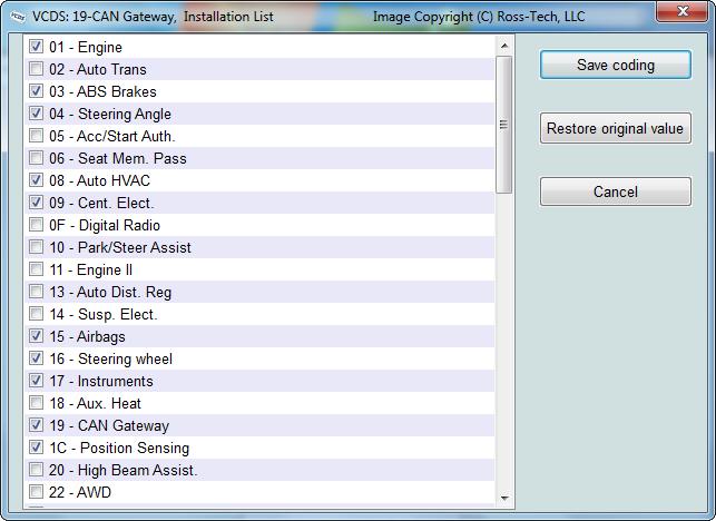

                  • Originally posted by cgentil View Post
                    Can't access that module because, but it's there.
                    Maybe the module does it itself?
                    are you sure that you registered the new module in the CAN Gateway list when it was installed?
                    • Originally posted by DV52 View Post

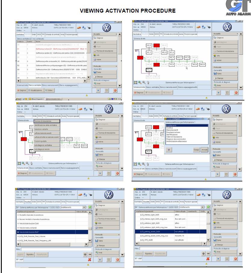

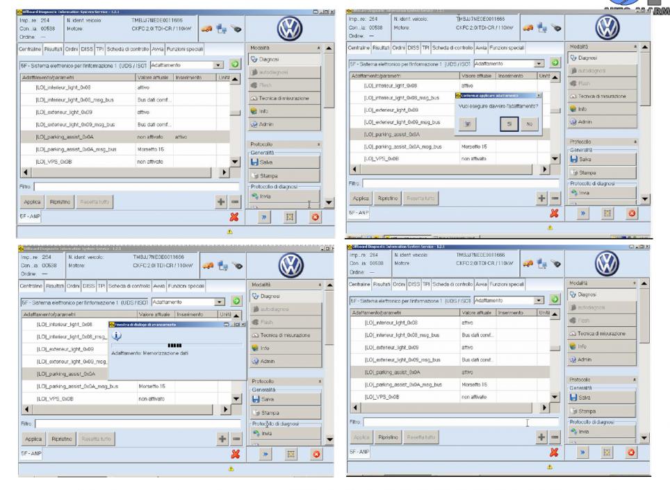

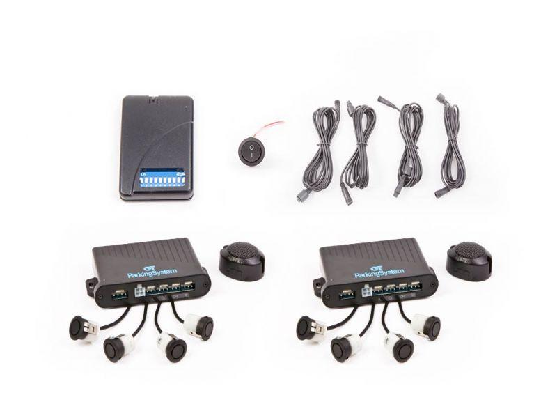

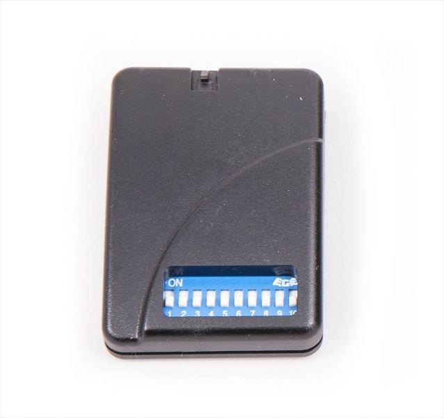

                            Hi,
                            Thanks for your reply. I only have that GT Alarm module.
                            But there's some info's about this module:
                            This is the kit they installed on car:
                            This is the Park view Module GT alarm:
                            Hope that can help.

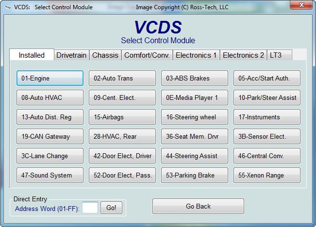

                            • cgentil: OK - as I suspected, the "GT Alarm module" is directly wired into the CAN bus.
                              Try entering "10", or "76" into the "Direct Entry" box at the bottom of the Select Control Module screen (see below)
                              Failing this - and I'm guessing again, but the new module must be thieving some of the CAN messages that would normally be the responsibility of the OEM module (i.e. J791). Clearly this has the side-effect of masking the module @ address hex10 from CAN Gateway module when it's performing the Diagnostic function. Very strange behavior, but probably something that can be best resolved through the GT alarm module manufacturer IMO. Non OEM - third party products can be tricky to fault-find (if this is indeed a fault- which it might not be)!
                              Don
