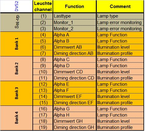

    "you need to tell me what the settings are for the full Leuchte-set for the Left/Right DRls. There will be 19 x adaptation channels for each lamp."
    Dark975: Hello again. I wasn't intending to go into a long winded discussion about Leuchte programming, but I have posted the table below in the hope that it can provide an overview of why I have asked for additional information.
    I've tried to show in the table the underpinning structure of a Leuchte-set (each of the 35 x lamps that the BCM can control on a mk7 has exactly this structure). The 19 x adaptation channels in the table form a Leuchte-set.
    Of particular interest in your case is the four "Banks". What I hope that you can see is that each of these banks can contain two separate commands that can operate the one lamp in different ways (the Alpha channels) -so each lamp can be programmed to work in 8 x separate ways. Any one of these "ways" can conflict with the other functions that the lamp is asked to perform and when making changes to a Leuchte set, it's important to be aware of the nature of other functions the lamp performs.
    In your previous post, you described a VCDS tweak that altered Leuchte channels (16) and (18 ) for both DRLs so that they blinked counter to the normal turn indicator. These changes looked OK, but in making them, you have given the new counter-blinking function the greatest priority and it will always "trump" any other function that the DRL performs. Unless I know what these other functions are, I can't tell if placing the new DRL counter-blinking function in the GH - bank creates a priority conflict, or not.
    This is why I have asked that you provide the settings for the complete Leuchte-set for the two DRLs
    Now, there are a couple of ways of getting these settings, but the easiest (but alas it takes the longest time) is to create an adaptation map of the BCM. Given that you are making changes to the BCM and because the BCM in an MQB platform vehicle contains around 2,500 adaptation channels, I assume that you have already created an admap. So, all that you need to do is to look through the .CSV file and post-up the two Leuchte-sets.
    Cheers
    Don

              • Hi Don. Sorry for the late reply. I was out of town without my car so I could not create the adaptation map until today. I sent you a private message for the link to may CSV file. I will be glad if you can have a look at it. Thanks in advance.
                Cheers
                Don

                    Dark795: I've parsed your adaptation map into a more readable form and I've included your Leuchte data into a spreadsheet to compare the settings in your car with those in my database. You will find a copy of the comparison spreadsheet showing your data HERE
                    I'm a bit puzzled with your settings because your car is set-up as incandescent fittings. The Leuchte channels that you refer-to in your last post (VLB10 and VRB21) are not active because these Leuchte-sets are not used in incandescent fittings.
                    Not sure what the history is for this car, but it looks like the BCM is set-up for bog-standard incandescent headlights
                    Cheers
                    Don

                          Dark975: Hmm.... I tried the change that I suggested in my table on my incandescent car and it works as indicated in the GIF pictures below the table. The tweak works perfectly on my car!
                          I've also had a closer look at the spreadsheet that I sent you (on dropbox). On your car there are only two Leuchte channels with the setting "daylight running lights" and these are the two shown in my table. So there are no other adaptation channels in your car that operate these two lights.
                          Given this confirmation, I'm at a loss to make any other suggestion (as I said before, your fittings have been modified so that the DRLs operate with low beams so I suspect that there may be some electronics inside your fittings that prohibit counter flashing of the angel-eyes.)
                          You could try changing the settings for the LEDs as a last suggestion. As I indicated in my previous post, this is done as follows:
                          CHANGE:
                          (1)-Leuchte5 TFL RB32-Lasttyp 5
                          (1)-Leuchte4TFL LB4-Lasttyp 4
                          from 9 - allgemeine Glühlampe 27W auch H15 to 35-kombinierte LED Blink-Bremsleuchten
                          AND:
                          (6)-Leuchte4TFL LB4-Dimmwert AB 4
                          (6)-Leuchte5 TFL RB32-Dimmwert AB 5
                          from 100 to 127
                          Cheers
                          Don
