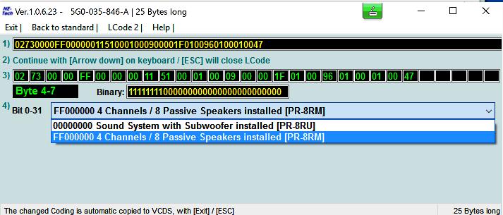

                    peekay: I can only suggest how to disable Dynaudio feature on a MIBI (not MIBII). I don't believe that it's done via an adaptation channel since disabling Dynaudio involves tinkering with a physical bit of kit - in my very limited experience, I've found that such exercises invariably are actioned via the module's coding string (I think).
                    Anyhow, I believe that the pertinent Byte(s) in address 5F are Byte 4-7. Here's a screen shot from the MIBI in my car showing the overall coding for these Bytes
                    If you just want to use the bog standard speaker system, then probably the FF00 string will suffice - this should just disconnect (in a software sense) J525 (Digital Sound Package unit) and the sub-woofers. However, if you do disable Dynaudio, what happens to the signal source for the normal treble/base speakers (which I think are all connected to J525)? These may need to be moved back to the rear of J794 (I think)
                    My other concern is what the MOST will do - but I don't think that j525 is connected to the ring topology (not really sure about this)
                    Finally, here are some code variances for Bytes 04/05 that I have amassed from various sources in my forum travels - can't vouch for them, but they may be of interest
                    04/05 Sound System Channels: 00 00 - B&O channels are managed by the external amp so they are not coded on the MU-H unit: FF 0A - Channel configuration for the Audi sound system (ASS):FF 00 - Channel configuration for the standard system
