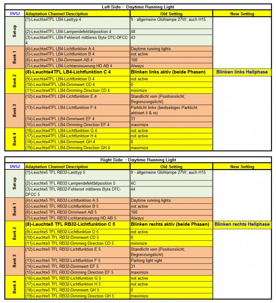

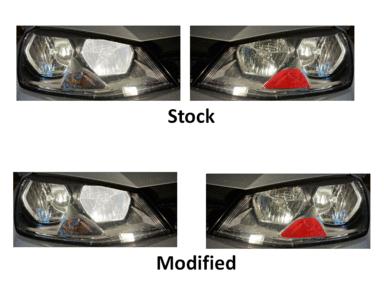

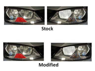

    • VCDS Tweak: Counter blinking DRLs on turn signal - Halogen Headlignts
      As factory fitted, the Halogen DRLs on our Australian mk7s have what is popularly known as "DRL wink". That is, the DRL turns-off on the side of the car where the turn signal is indicating. The VCDS tweak below modifies the behaviour of the DRL so that it counter blinks (instead of "DRL wink") with the turn signal - see the GIFs below. The other functions of the DRL are not modified by this tweak (i.e. the parking light function and the single sided parker function remain unchanged). This tweak is designed solely for incandescent headlight assemblies.
      I have implemented this tweak on my 103TSI and I can vouch that it works. Please note that I make no judgement regarding the compliance of the "Counter blinking DRL" with the Australian Design Rules. Those intending to implement this tweak should satisfy themselves in this regard.
      Cheers
      Don
      VCDS Tweak Instructions: Counter Blinking DRLs - Halogen Headlights
      1. Select 09 - Central Electr control module
      2. Select Security Access - 16 from the "Open Controller" screen
      3. Enter the magic number 31347 and return to the "Open Controller" screen
      4. Select Adaptation - 10 from the "Open Controller" screen
      5. From the pull-down button check that the default settings for the adaptation channels shown in the table below are as indicated in the Old setting column
      6. Change the two Leuchte channels depicted in the table below to the values in the New Settings column
      Notes:
      1. TIP: use the "search" facility on the latest RT software to find the two channels listed below as follows:
        • [*=1]Enter LB4 into the search box to find the Left Hand DRL channel
          [*=1]Enter RB32 into the search box to find the Right Hand DRL channel
      2. Only 2 x adaptation channels need to be changed - I've shown the complete Leuchte-set in the table above for completeness.
      3. Do not proceed with this tweak if the remaining channels are not as shown in the "old setting" column
      4. If you want the DRLs to blink in unison with the turn signal, , change the setting (instead of the "New Setting" above):
        1. ( 8 )-Leuchte4TFL LB4-Lichtfunktion C 4 to Blinken links Dunkelphase
        2. ( 8 )-Leuchte5 TFL RB32-Lichtfunktion C 5 to Blinken rechts Dunkelphase

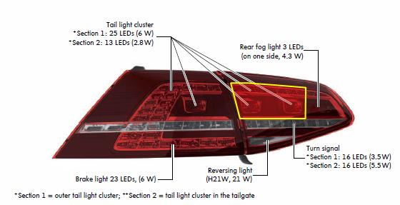

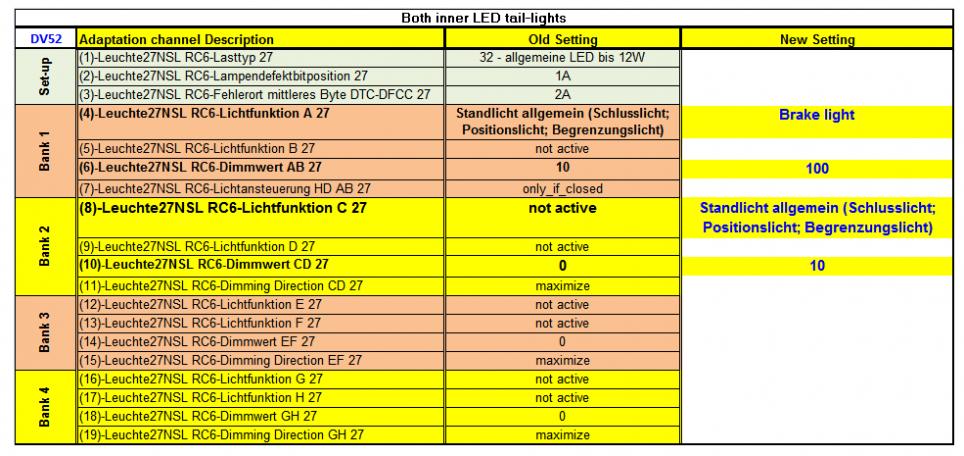

                            • LED Tail lights - Add Brake function to inner lights
                              The mk7 VCDS reference thread contains a tweak for adding the brake function to the inner lamps on mk7s with incandescent fitting, but I was asked recently to do the same for a Golf R which had LED rear tail lights. The following instructions will do just that - I hope!
                              I've yet to implement the tweak on the Golf R, but I'm reasonably confident that the instructions will work - if anyone tries it before I get access to the Golf R, please provide feedback
                              VCDS Tweak - Add "brake" function to "inner" tail lights
                              Preface: The fittings that will be altered by this tweak are those that are physically installed in the hatch lid (tailgate). The picture below shows the LH fitting and I have circled the relevant LEDs for reference (note: both left and right side fittings will be altered).
                              As some will already know, the BCM manages lighting for the car's exterior lamps - in this instance the left and right side bank of LEDs on the inner rear fittings are each connected to the one pin on the BCM (i.e. PIN #6 on Socket C). This means that only one Leuchte-set needs to be altered (i.e. not surprisingly the Leuchte-set designated C6).
                              For the Leuchte-geeks, the two inner LED fittings are factory programmed to perform only one function; that being as a parking light with the illumination level set to a value of 10. To add the brake function, it is necessary to move the parking light function to the CD alpha pair thus allowing the vacated AB alpha pair to be used as a brake light. This gives the Brake-parking light combination the correct priority in instances where both functions are operated together
                              Instructions
                              5. Change the four Leuchte channels depicted in the table below to the values in the New Settings column.
                                Suggestion: use the "search" facility on the latest RT software to find the channels listed below as follows:
                                Enter LRC6 into the search box to find the inner LED tail-light channels
                              Notes:
                              1. Four adaptation channel settings need to be changed as per the table above, but I have included the complete Leuchte-set for reference and for checking the suitability of the tweak on your car
                              2. Do not implement these instructions if the Old Setting values are not the same as shown in the table

                                So maybe this explains whey it does not work, because at your below statement it says it is beaten by park light ?
                                By placing the Hellphase/Dunkelphase setting on channel ( 8 ), I have given the blinking function a relatively low priority. The blinking function for the LEDs has a higher priority than the DRL function, but it is "beaten" in priority by the Parking light function.
