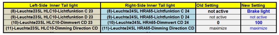

        • Incandescent Tail lights - Add brake function to "inner" lights
          The operation of the incandescent taillights on a mk7 is fairly austere (IMO)! Particularly the "inner" lights that are fitted to each side of the hatch door. As stock, these lights do nothing more than function as parking lights and in this mode, they are programmed to illuminate to 28% of full intensity. The "outer" lights work a bit harder in that they function as brake lights, general parking lights, and as one-sided parkers- when the indicator stalk is activated and the car is locked.
          Fact is that any of the tail lights (and all exterior lights on a mk7) can be programmed to function in a variety of ways because of the manner in which VW has implemented the Body Control Module (BCM) on MQB platform vehicles. However, the ardour of those interested in creating these tweaks is limited by the boundaries set by the Australian Design Rules (ADRs) which specifies how cars must be lit (amongst other things).
          I developed the tweak below to make the inner lights on my incandescent tail light assemblies work harder. In essence, the tweak adds the "brake" function to these two lights so that both the outer and inner tail lights (on both sides) will illuminate together when the pedal is pressed - as well as the high level brake light (see my animation below). I argue that this makes my vehicle more "visible" to the cars behind when I'm braking.
          The stock "parker" function of the inner lights is unaffected by this tweak, and I have placed the new function in the Leuchte cannel-set so that the brake lights always have priority over the parker function. I assume that the tweak complies with the ADRs, but I advise that those seeking to implement these instructions should satisfy themselves in this regard.
          VCDS Tweak - Add "brake" function to "inner" tail lights
          1. Select 09 - Central Electr control module
          2. Select Security Access - 16 from the "Open Controller" screen
          3. Enter the magic number 31347 and return to the "Open Controller" screen
          4. Select Adaptation - 10 from the "Open Controller" screen
          5. From the pull-down button change the adaptation channels shown in the table below to the New Settings as indicated:
          Notes:
          1. The adaptation channels settings on (9) and (11) for the left and right side lights do not need to be changed. I have included these in the table to complete the alpha-channel sub-set entries
          2. Do not implement these instructions if the Old Setting values are not the same as shown in the table

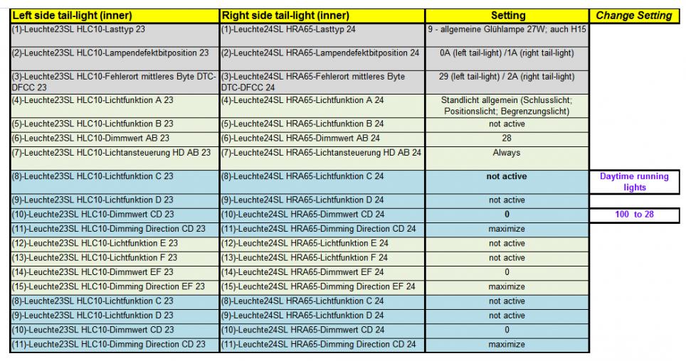

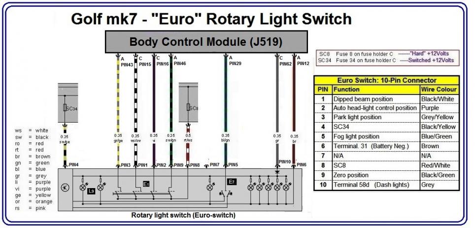

                            • interesting conundrum, hoping for some insights
                              i have a ’15 GTI SE and have installed a P3Cars gauge, wired into the autodim switch and set up to dim when the headlights come on. as an aside, it took me a while to figure out the right wire coming off the headlight switch harness to wire up for the autodim to work - on my North American 15 GTI this is the solid gray wire.
                              all was working as expected and designed UNTIL i decided to change the daytime running lights behaviour via VCDS…and herein lies my question.
                              9 - Central Electronics > (6)-Daytime running lights-Tagfahrlicht-Dauerfahrlicht aktiviert zusaetzlich Standlicht > set to ACTIVE turns on the parking lights in the rear when the DRL’s are on. this works as advertised, but also dims the P3Cars gauge. arg!
                              It appears that the following options might have something to do with this:
                              17 - Instruments > (1)-Illumination_algorithm-Scale_switching_algorithm > parking_light seems MAY be contributory to controlling dash instrument lighting. changes to this have no affect on dash instrument lighting regardless of parking light illumination. options here are "not intalled, parking_lights, lds, and not active". as stated, it doesn't appear to affect dimming state, though, and i can find zero documentation on-line - any ideas what "lds" might be? am i barking up the wrong proverbial here?
                              is there a way (without regrouping all the parking lights into a different lighting group, say "10 allgemeine Scheinwerfer" (general headlights) wherever they’re found, which may or may not have the desired effect?) to run the rear parking lights WITHOUT dimming the instruments and hence the gauge?
                              what i'm after is a way to run the rear halogen tails' parking lights with daylight running lights in auto WITHOUT dimming the dash? while your insights into the instrument lights are fantastic, i don't think a change here to the dimming profile or affecting VCDS coding changes to the photosensor are the answer, it's more a no/no-go for the dash lights with the parking lights - they seem linked.
                              i hope i'm making sense.
                              the resources here are INVALUABLE, i’ve read all your papers Don, googled, poured over the VCDS output form my car, had a German friend translate, tried everything i could think of (so yes, n00b did search!), but it’s not jumping out at me immediately, so i figured id’ ask if you had any insight here.
                              thanks much in advance,
                              tGo
                              • greatoz: First, many thanks for your kind and generous words - I consider much of the stuff in my papers to be fairly arcane, so I'm pleased to hear that they have been of use!
                                OK, now to the content of your post: I'm have not used the daytime running light tweak that you have implemented (I believe that it's called the "Scandinavian" arrangement), but I have spent time trying to understand how the rotary light switch (Euro-switch) on a mk7 works.
                                Here's a copy of how I believe that the euro-switch on a mk7 is wired:
                                The tricky bit about a euro-switch (IMO) is the fog-light. There is only one wire on the device to initiate both the front and rear fog lights! When I pulled my switch apart, I found that there was an imbedded IC (integrated circuit) connected to PIN 5. This IC was clearly the "smarts" that the BCM needs to determine which set of fogs to illuminate. When I put a CRO (Cathode Ray Oscilloscope) onto PIN 5, I found that there was a form of PWM (Pulse Width Modulation) happening! Not sure why this level of complication is necessary when a simple second wire would have sufficed - go figure!!
                                Anyhow, this is all an aside to confirming that the solid grey wire from pin 10 of the euro-switch is indeed the trigger wire to illuminate your new gauge when the instrument cluster is lit-up.
                                As for your observation that the Scandinavian arrangement dims the gauge lighting, there's not much that I can add - sorry. BUT you might want to consider the following two suggestions:
                                Suggestion 1. This is a long-shot, but recently I wrote-up tweak instructions that illuminated the instrument cluster during daylight hours. You could try implementing my tweak (click HERE) in the hope that it consequentially modulates the signal trace on PIN 10 on the euro-switch. I've implemented this tweak and it has had the affect of intensifying the illumination of other devices in the cabin during daylight hours (like the infotainment screen). If you look at the direction of the internal diode in picture above, it suggests that the BCM sends a voltage signal to the lamps within the euro-switch (i.e. the BCM provides the forward bias for the diode). Again, a long shot and I'm not sure if this option will work - but it might be worth a try!
                                Suggestion 2. if suggestion 1 doesn't work, a more plausible alternative solution is to turn-off the Scandinavian light tweak that you have implemented and to have the tail-lights perform the same function via "Leuchte programming". Now, I've not made the changes that I'm about to suggest, but you will doubtless be aware that it's possible to program any of the external lights on a mk7 using this process.
                                As you know, our cars down here don't have the steering wheel on the wrong side and our tail-lights here have separate lamps for the turn indicators (albeit, our ADRs are no better than your DOT rules). But, my assumption is that the parking light function (and therefore the lamps that will perform the rear DRLs function) on your car are the two inner tail-lights. If so, then the Leuchte channel sets of interest will be:
                                • Leuchte23SL HLC10 - Left tail-light (inner)
                                • Leuchte24SL HRA65 - Right tail-light (inner)
                                Fortunately, I have a 15 GTI SE 6MT model (NAR) in my database and the default settings for the two Leuchte channel sets that I have listed are:
                                If your car has the same default settings, then I suggest that you delete the Scandinavian setting and that you make the changes that I have shown in the table. To explain my notation for the "Dimmwert" channel, I'm not sure how bright you want the rear DRL function. If you want them to be fully illuminated, then use 100, else reduce this value as desired.
                                Please note that both these suggestions are untested
                                Good luck
                                Don
                                PS: If the default settings on your tail-lights are not as I have listed in the table (or if you want to use the outer pair), please provide a listing of the values in your car for the Leuchte Channel sets ( the outer tail-lights are: Leuchte20BR LA71 - left, and Leuchte21BR RC8 - right). I will work-out a new set of tweak instructions
