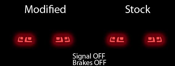

Here's an example of a modification of the tail lights on a NAR GTI (to a version of Golf R tail-lights) that a fellow forum colleague (JBale) managed to achieve through innovative use of Leuchte programming (note: this wouldn't be legal in Australia)
