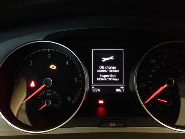

    A week or so ago, my MY13 TDI started reminding me of imminent service due, which seemed odd, since it's not due 'til late October on time and over 13000K on distance, and the time has been counting down daily.
    Today it was down to 13600K/3 days.
    At first I thought maybe the dealership hadn't reset the counter at the last service, so reset it by the method given in the manual — hold down the reset button on the MFD, turn ignition on, release and press again, switch off (a clumsy procedure that doesn't always work, BTW, but succeeded after several tries.)
    The popup now reminds me that it's due in 15000K/3 days.
    Checking the details in the centre display (which doesn't give you any options to change) shows that the change was indeed made (at least in part) — it now shows "oil change due in 15000K/365 days", which is what you'd expect to see following a reset.
    Beneath that line there's another: "Volkswagen inspection due in 26400K/3 days" which, so far as I can see doesn't chime with any date in the car's history, but obviously is where the popup is getting the number of days.
    Clearly something's not right — but what?
    Before I start with VCDS, has anyone else encountered this one?
    • Yes, me. The reset doesn't do anything either for me. Says it resets it, but the Service Now! message just displays again. So I'm in the same boat as you. Next service is due in May.

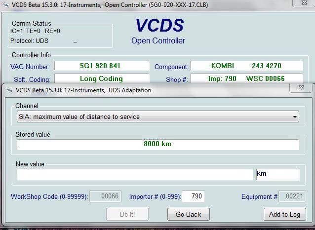

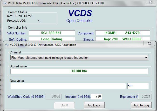

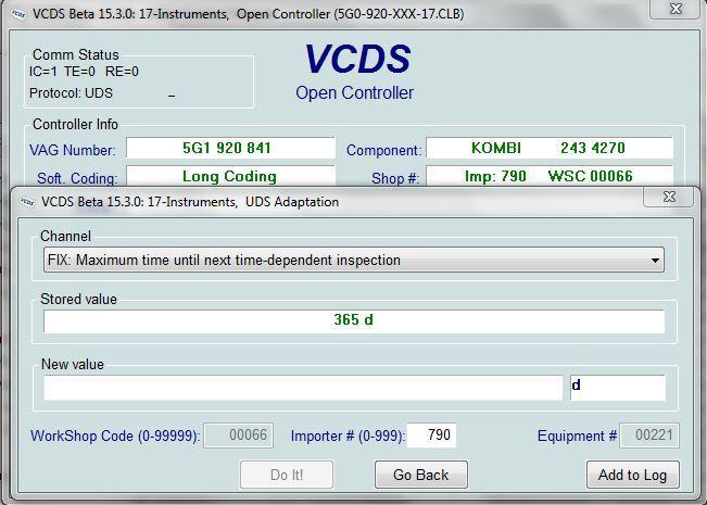

      • ^^^^^ That's real strange! what does the adaptation channel in the red rectangle below say on your cars?

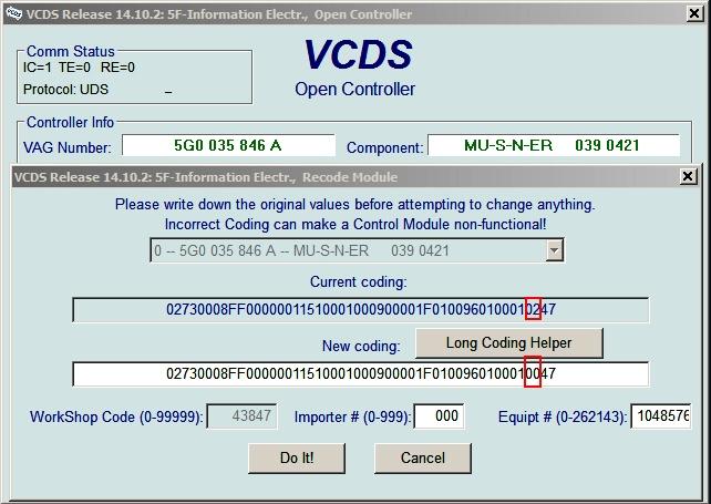

            Hi, Does anyone know how to remove this permanently? it comes up every second time I turn the ignition on...

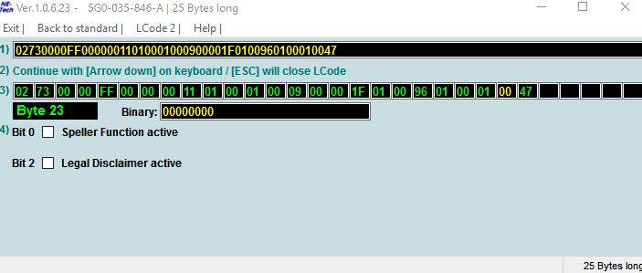

            try 5F-> Byte 23 -> 00 (uncheck all)

              @zloybob - will that work for the all the annoying nag messages? I might give that a go when I have my VCDS laptop with me and some time.

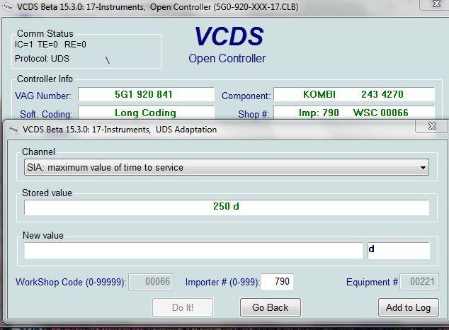

                  • ^^^^ Ben, on your NAR model SIA must be equal to FSI on our ROW vehicles. This is still a set maintenance interval based only on distance travelled and elapsed time - but yes both these variables can be changed using a VCDS cable
                    • Originally posted by zloybob View Post
                      zloybob: I've said it before and I'll say-it again - you are a Russian genius (absolutely no doubt about it)! Thank you very much for the instructions
                      Tried your tweak this afternoon and so far - no nag screen on the SATNAV.
                      I tried reverting the settings back to the original coding values just to see what would happen and hey-presto immediately got the nag screen. I've left the coding to Byte 23 set to 00 to see if this setting upsets anything else in the infotainment system, but so far everything is working OK. Incidentally, for anyone else trying zloybob's tweak, you will need to re-establish your old FM radio settings, I lost RDS and TP (and consequently, no traffic reports). But it's a simple matter to re-instate both facilities- TMC works OK again.
                      Edit: 17 March 2015- after about a month since I implemented zloybob's tweak, I've not had the nag screen appear on the discover media screen and no unexpected impact on any other facility in the car. Fairly safe to say that the tweak works-thanks again zloybob
                      Edit_2: With the release of a label file for the 5F control module with VCDS software version 15.7.3, the long coding helper is a more expedient way of implementing this tweak - see screen shot below (remove tick from Bit 2)

                        • Originally posted by DV52 View Post

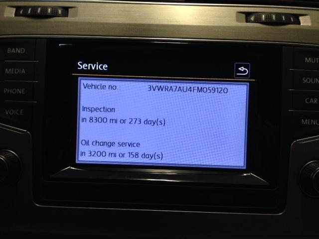

                          Yep...you are correct Don, thanks I've aligned them now so my oil change is set for 5,000 miles and 250 days, and I have an inspection/service at 10,000 miles 365 days.
                          Current: 2017 GTI S, 6 spd man; 2017 Jetta SE TSI, 5 spd man
                          Previous: 2015 Golf S TDI, 6 spd man; 2015 Jetta SE TDI, 6 spd man; 12 Jetta 2.5L, 04 Jetta 2.0L, 02 Golf 2.0L, 98 Jetta 2.0L, 98 Golf 2.0L, 98 Cabrio 2.0L, 95 Golf 2.0L, 87 golf GTI 16 valve 1.8L, 86 Cabriolet 1.6L, 80 Audi 4000 1.6L, 76 Audi Fox 1.6L, 76 VW Beetle 1.6L, 74 Audi Fox 1.5L, 69 VW Beetle 1.5L
                          • This is what I finally came up with. This aligns the 10,000 mile/1 year service with the service indicator and adding an oil change every 5,000 miles/250 days instead of 10,000/365 days.
                            -Ben
