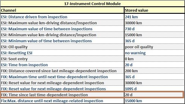

      • Originally posted by DV52 View Post
        ^^^^^ That's real strange! what does the adaptation channel in the red rectangle below say on your cars?
        On mine it said 3 days — just as the display said.
        Today I tried resetting with VCDS — the times and distances are easy enough to change and they are accepted, but the MFD display doesn't change.
        It's now showing "Service Now!" on both MFD and screen, and so far I've not been able to make it go away.
        Not only that, it over-rides all screens bar reverse camera and parking sensors.
        Down near the bottom of the adaptation list there's an option to clear all service displays (or it might be entries — I forget in moments these days), but without knowing what it'll do I'm not going to use it.
        Just booked it in at the dealer's for Thursday morning — they now say it'll take about an hour and a half (I'd have thought five minutes, but...)
        The nag screen clearance worked a treat — thanks to all involved (wish I were half as smart.)
        • Originally posted by Idle View Post
          Idle: that's strange, normally, all you need to do is to change the distance and elapsed time channels (unless you have ESI (see my previous post) in which case you will need to reset the ESI channel.
          Here's how Ross Tech say that it should be done on a 5G/AU (i.e. mk7) vehicle SRI RESET
                Looks like success, many thanks for the link (an my father were here, he would thank thee also.)
                Shall joyfully cancel the dealer appointment in the morning.
                Yes, I do have ESI — that was the snag. Hadn't realised it needed resetting.
