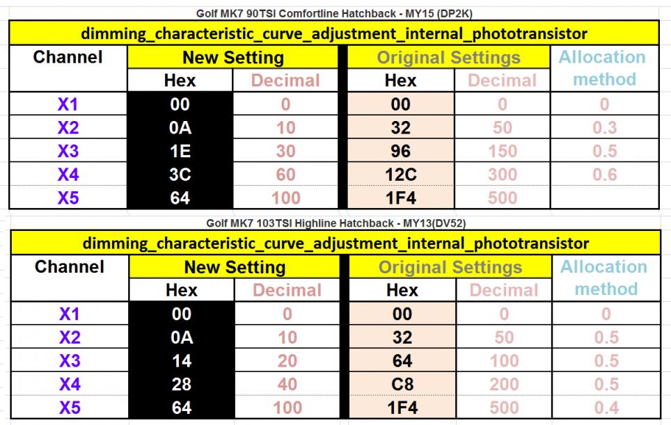

                          • Security code 20103 doesn't work for my instrument cluster on my my16 any ideas of alternatives?
                            Originally posted by DV52 View Post
                            Dennis: Hello and thanks for the post (and, thanks also for the kind words).
                            I'm always learning new stuff about the mk7 models - I wasn't aware that the 90TSI had the "X" settings that you describe in your post. Not sure why this happens (perhaps VW use a different type of photo-transistor in the 90TSI instrument cluster) but it just means that the response characteristics of the photo-transistor is different for the mid value light levels X3 & X4 in your car (I think).
                            Here is the portion of the autoscan from my 103TSI showing the instrument cluster details. Are these the same as yours?
                            Address 17: Instruments (J285) Labels: 5G0-920-XXX-17.clb
                            Part No SW: 5G0 920 860 HW: 5G0 920 860
                            Component: KOMBI 235 0555
                            In any event, whilst I don't believe that the different settings are a problem, I have re-jigged the settings in my original table to reflect the dimming curve in your car. For reference, I have also included my original table (for other folk that might be reading this reply). Please use the settings appropriate for your car to ensure the tweak delivers the original VW factory response profile.
                            Hmmm............. this is puzzling!! You appear to be using the correct arrangement of numbers. I mentioned in my paper that I also had occasional problems during my experimentation phase when changing settings in these adaptation channels. I found that the most important part of the tweak was ensuring that the security code is accepted (first time). If this didn't happen, I found that the rest of the tweak invariably went pear-shaped!
                            Suggestions:
                            1. Make sure that you are using the latest software
                            2. IF the security code isn't accepted, wait a while before trying again (the cable will give you a message about how long to wait - can't remember the time)
                            3. Try changing the X values in reverse order (i.e. start with X5 and work-down)
                            Cheers
                            Don
                            PS: congratulations on the new car and welcome to the 2nd-best VW forum on the web (I haven't yet found the best VW forum)!
                            • Originally posted by Bizmo View Post
                              Bizmo: Hi and welcome to the forum- how is your (late) summer way up there in the extreme north?
                              I'm almost certain (can't be 100% sure of anything when it concerns any of VW's control modules) that 20103 is the correct security code- but yours is the first MY16 model that I've heard-of with this problem. As I said in my instructions, I also had the occasional difficulty getting the control module to accept this security code on my MY13 car when I was developing the tweak. But with perseverance, I eventually got access. Please be aware that the control module might lock-out for a period of time if an unsuccessful attempt is made.
                              When I was experimenting with this tweak, I found that the best way of getting the module to accept the security code was to have the motor running before opening the control module and to be EXTREMELY careful in entering the number.
                              I also found that if I made an error (and I did make many of these), it was prudent to just go-away and have a glass (or two) of scotch before trying again! Hmm.... maybe that's why I made so many errors!
                              Anyhow, if you can't resolve the problem, please provide a copy of the portion of your auto-scan report for the instrument control module. This will allow those reading your post to see the hardware/software details of the device on your new car
                              cheers
                              Don
                              PS: Out of interest - which of the two dimming curves in my table above is used on a MY16 mk7? Or, does your car use an entirely different dimming curve? If so, I'd welcome details of the default settings for the five "X" values on your car
                              • Originally posted by DV52 View Post
                                cheers
                                Don
                                PS: Out of interest - which of the two dimming curves in my table above is used on a MY16 mk7? Or, does your car use an entirely different dimming curve? If so, I'd welcome details of the default settings for the five "X" values on your car?
                                Thanks for the reply, late summer is pretty good, still a bit warm and heading into autumn!
                                tried this a number of ways including with the ignition on and off but no luck, this is the error I get....
                                I have posted a full scan of the car below (in a second post!) and FYI the default settings for the dimming are the same as for your MY13 car
