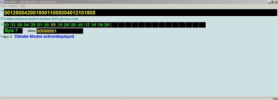

                    • Hey Don, was having a look in the long coding for the Auto HVAC control module the other day, came across an option to "Display climate modes". Do you know what this is?
                      I enabled it but couldn't see anything obvious.
                      I haven't got any screenshots unfortunately, but can get one if you don't know what I'm talking about.

                        • Originally posted by agentthumb View Post
                          Agentthumb: Hello
                          I think that you are referring to Byte 7 (see below). Bit 0 of this byte was set on my car from new and I had always assumed that this is the factory setting if the car is fitted with Climatronic air-conditioner. Not sure why I made this assumption - I could be entirely wrong given that you also have a 103TSI! Anyway, if I press the set-up button on the air conditioner knob (the bottom half of the central round knob), I get the option to choose three profiles. Could be related to this facility?
