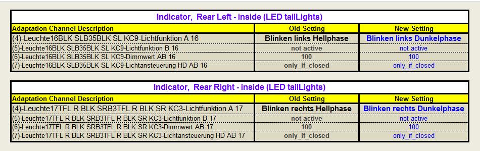

      • VCDS Tweak: Pace-Car indicators for dual LED tail lights
        As a factory setting, VW program their vehicles that are fitted with dual LED rear lamps so that the outer and inner LED indicators flash in unison with one another (i.e. they pulse on/off together). I recently found an interesting German video (copy below) showing Dual LED rear lamps that flashed asynchronously when the turn signal was operated. Clever folk those Germans!!
        Galvanised into action by this intriguing (at least to me) lighting effect, I managed to develop a set of Leuchte programming instructions that would mimic the operation of the indicator lights in the video. Thought that it might be of interest to forum members that have dual LED fittings on their rear lights (like the Golf R).
        For fellow "Leuchte geeks" (I proudly acknowledge being one!) reading this, the tweak uses the AB Alpha pair, which has the lowest priority in the Leuchte-set and it is based on the (less familiar) Blinken link/rechts Dunkelphase setting. But, the interesting part of the tweak is that instead of the usual practice of linking this setting with Dimmwert=0 and Dimming Direction=minimum, the tweak uses Dimmwert=100 and Dimming Direction=maximum (which is applied to the Heckdeckel channel on the AB alpha-pair). Fortuitously, both these settings are already set-up as default for the Dimming channels on the left/right side inner rear lights. This means that only Leuchte channel (4) on each lamp needs to be changed - making this a very simple tweak to implement! Programmed in this fashion, the LED indicator that has the Dunkelphase setting pulses counter to its neighbouring LED indicator which continues to use the factory programmed Hellphase setting. Here endeth the "geek" part of the tweak instructions!
        Because my 103TSI mk7 has incandescent rear lamps, I have not been able to test this tweak on my vehicle (albeit, I suspect that a similar effect can be implemented by tweaking Leuchte23SL HLC10 and Leuchte24SL HRA65 on cars with incandescent fittings- something for a later experiment, perhaps). However, a forum colleague on VWVortex has confirmed that the tweak was successfully implemented on his vehicle (thanks Chillout). Also, I've been told by more knowledgeable folk (thanks again Chillout) that an appropriate description for the lighting effect is "pace car indicator" (I had never seen a pace-car, let alone knew how its lighting operated) - hence the heading to this post.
        Lastly, I make no judgement regarding the compliance (or otherwise) of the "pace car indicator" with the Australian Design Rules ADR here in Oz, or whatever local legislation applies in other countries. Those wishing to implement the tweak will need to reach their own conclusions regarding this matter.
        VCDS Tweak Instructions: "Pace - Car" Indicators for dual rear LED light fittings
        1. Select 09 - Central Electr control module
        2. Select Security Access - 16 from the "Open Controller" screen
        3. Enter the magic number 31347 and return to the "Open Controller" screen
        4. Select Adaptation - 10 from the "Open Controller" screen
        5. From the pull-down button check that the default settings for the adaptation channels shown in the table below are as indicated in the Old setting column
        6. Change the two Leuchte channels depicted in the table below to the values in the New Settings column.
        Suggestion: use the new "search" facility on the latest RT software to find the channels listed below as follows:
        • [*=1]Enter Leuchte16BLK into the search box to find the Left Hand LED channels
          [*=1]Enter Leuchte17TFL into the search box to find the Right Hand LED channels
        Notes:
        1. Only one Leuchte channel for each of the left, right side lamps needs to be altered (i.e. (4)- Leuchte). I've included the remaining channels in the Leuchte sub-set as an aid to check the suitability of this tweak
        2. Do not implement this tweak if:
        1. The vehicle does not have dual LED indicators on each side
        2. the default settings on the vehicle are not as shown in the "old setting" column

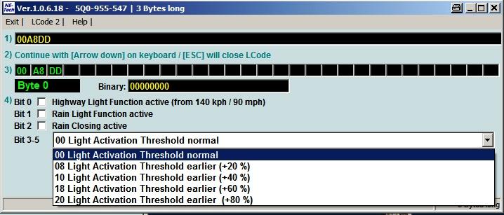

            Flipper dog: Regarding the sensitivity of the auto lights, I assume that you are aware of the facility in the MENU screen to adjust the turn-on characteristics of the light sensor.
            Not sure if you are aware, but VW install three different versions of the light sensor in their mk7 models; the RLS, RLHS and RLFS. Which version is in your car? Again, forgive me if I'm telling you something that you already know, but the RLS/RLHS/RLFS is a slave module to the BCM.
            The sensitivity adjustment for the three light sensors is generally managed by Byte 0, Bit 3-5 (see pic below). Actually, I believe that the long coding helper in RT's software is in error. The real Bits for the sensitivity function are Bits 3-7 - because it's not possible to define the hex values shown below in only 3 bits
            As you can see, assuming that your module has the default value Hex00, the trouble is that the sensitivity adjustment is in the wrong direction for your problem. - Bummer!
