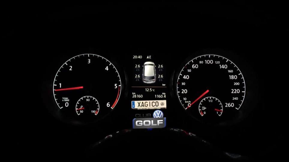

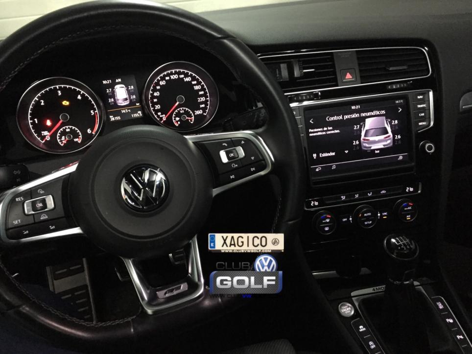

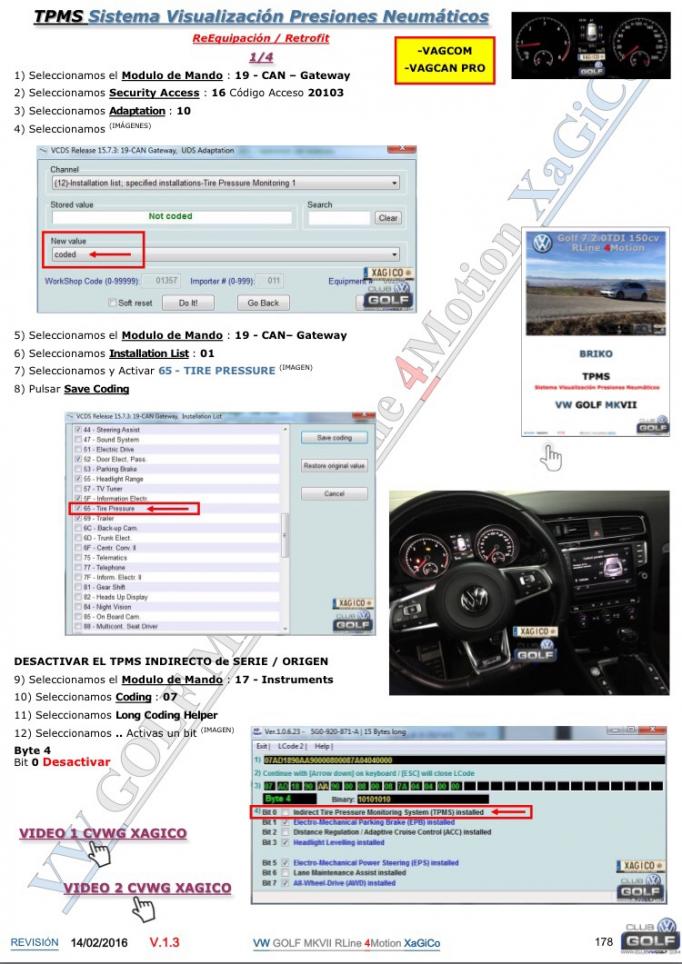

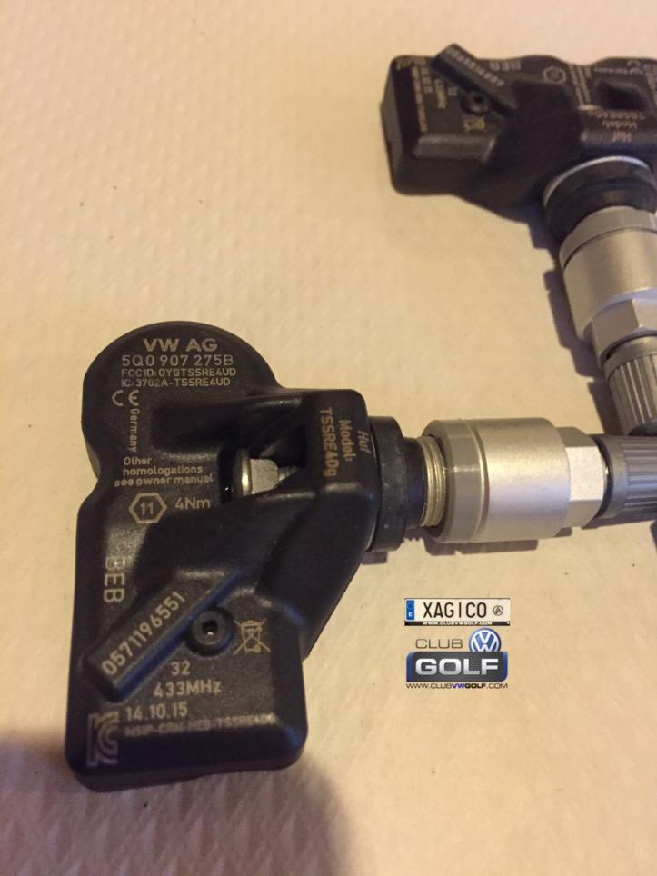

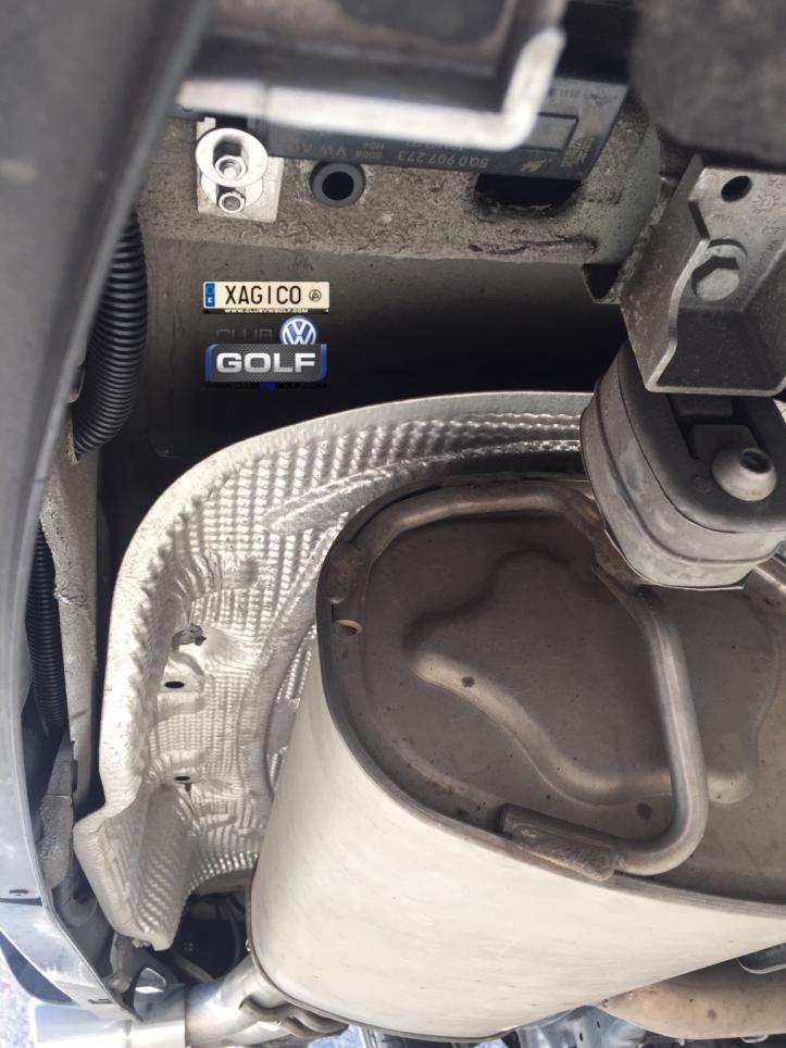

            • Hello Family!
              TPMS (Tire Pressure Meter System) para VW Golf MKVII
              TPMS VW Golf MKVII RLine 4Motion 1/2 - YouTube
              TPMS VW Golf MKVII RLine 4Motion 2/2 - YouTube
              Codificación Completa:
              Ingredientes Principales:
              Unos 300€ de inversión!
              - 5Q0 907 273 / 5Q0 907 273A -> Centralita TPMS
              - 8E0 971 934 A -> Conector Centralita TPMS
              - 5Q0 907 275 / 5Q0 907 275B -> 4 Válvulas TMPS
              - Cable
              - VAGCOM
              - VCP (opcional)
              Good Night!

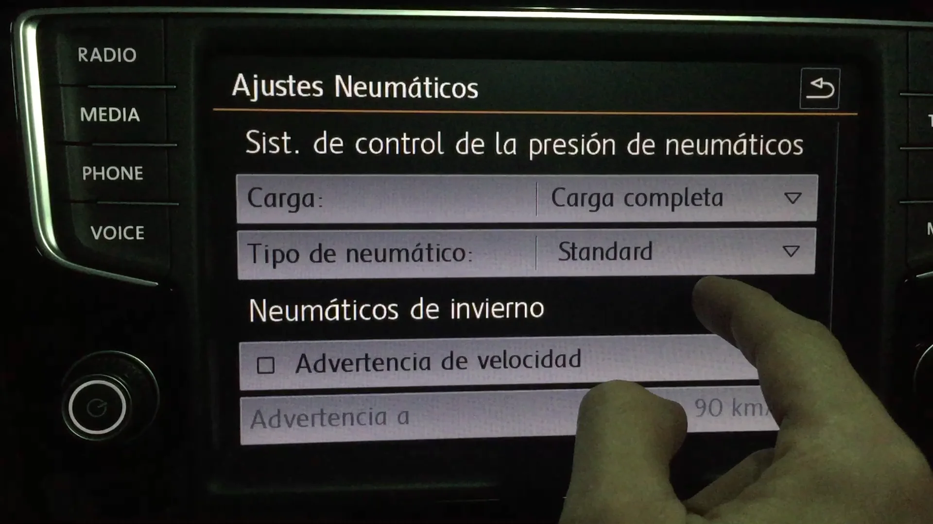

                  • XaGiCo
                    Hello, I retrofit it too =)
                    do u have this menu? (Choose tire type)

                        • Originally posted by zloybob View Post
                          XaGiCo
                          Hi @zloybob
                          I do not see that screen!
                          you can help!
                          you can skip coding?
                          Thanks !!'
                          Regards
                          XaGiCo
                          • XaGiCo,
                            In your video the item Standard and its not work for you?
                            Its not coding. Its edited manually zdc.
                              XaGiCo,
                              Hi @zloybob
                              Look long version of the video.
                              That has the file name ZDC you used?
                              Thank you.
