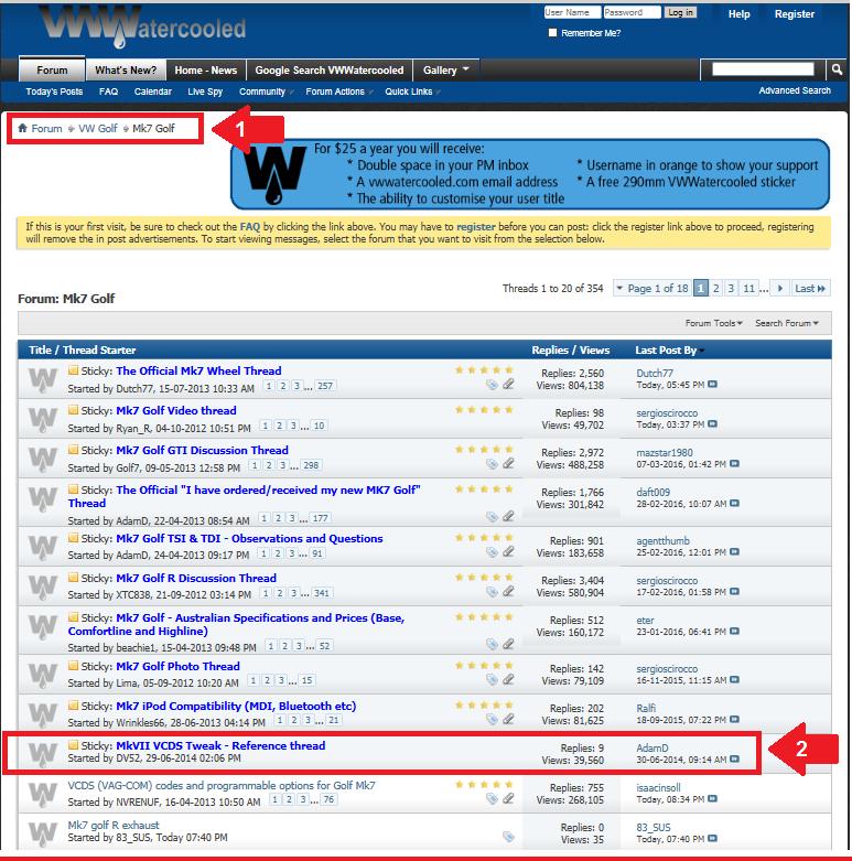

            • Is there a wiki/post/document containing all tweaks so I don't have to read through 750 posts?
              • The thread above this one when its at the top...
                GTI MY16.5 PURE WHITE | LAKIN PLATE HOLDER | TINTS |
                • Originally posted by isaacinsoll View Post
                  Isaac: Hello and welcome to the forum. I think what Ozram means is make sure that you are at the Forum shown in Arrow 1 and then click on the thread in arrow 2 (below)
                  Don

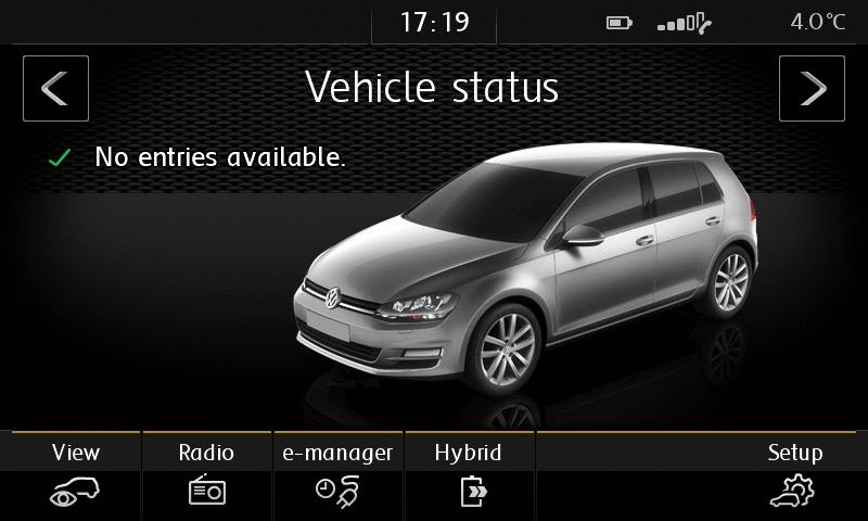

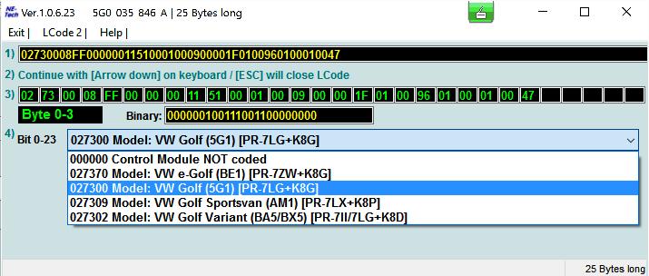

                    • GTE/E-Golf graphic instead of default:
                      Module 5F
                      Long Coding
                      Byte 2, value 70 instead of 00.
                      I will mess some more with this byte. Previously, only byte 18 seemed to influence the specific type of car (GTI or standard).

                        • Originally posted by Chillout View Post
                          Module 5F
                          Long Coding
                            Module 5F
                            Long Coding
                            Hey Chillout, e-manager and Hybrid disappears from the bottom menu after the modification?
