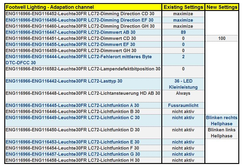

          • Footwell Lighting enhancement - Hearing Impaired Aid for Turn-Signals
            I developed this tweak after being approached by an acquaintance that had a hearing difficulty. Her initial question to me was: is it possible on a mk7 to increase the volume of the "ticking-sound" when the turn indicator is enabled?
            After a number of unsuccessful hunches and after following numerous web-site leads, I came to the unfortunate conclusion that the answer to the question was NO (or, phrased more accurately, no-one seemed to know how to do this).
            So I turned to an admittedly less effective, but hopefully still helpful alternative of using a visual prompt to achieve the same result. As some (many?) would already be aware, the Leuchte-sets in a mk7 are principally focussed on controlling the vehicle's exterior lamps. The one exception is the footwell lighting which all the cars in my database indicate use LED lamps. The tweak below adds the turn-signal functions to the footwell lights so that they pulse to indicate to the driver that the blinkers are operating. Because of the rating of the LEDs, the effect is not dramatic during daylight, but it's more effective at night!
            Anyhow, I enclose the instructions below in the hope that the tweak might be useful to others in a similar situation!
            Don
            1. Select 09 - Central Electr control module
            2. Select Security Access - 16 from the "Open Controller" screen
            3. Enter the magic number 31347 and return to the "Open Controller" screen
            4. Select Adaptation - 10 from the "Open Controller" screen
            5. Enter "LC72" into the search box and from the pull-down button check that the current settings for all the adaptation channels shown in the picture below are as indicated in the Existing Settings column (note I have shown the latest RT nomenclature for adaptation channels which include the "Object tags")
            6. Change only the Leuchte channels as per the picture below to the values in the New Settings column
