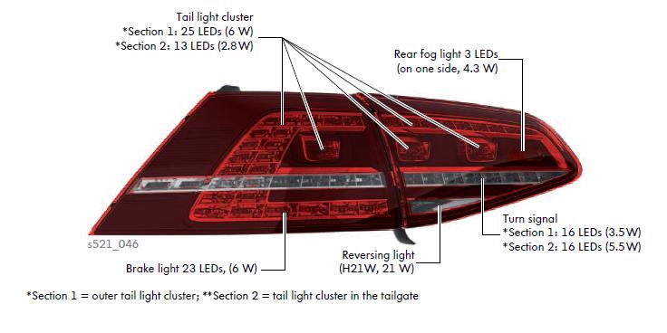

              • my Brake/Indicator LED at the edge of my outter tails doesn't seem to like turning on (See Image)
                any ideas on how to turn them on?

                    • Originally posted by fonsii View Post
                      fonsii: Nice picture, but I don't understand the question - alas! To which section of the tail-light fitting on the picture below are you referring (note that the tails have an un-lit border surrounding the LED clusters)?
                      Don
                      • thanks for the reply! see image^
                        so upon braking the red led at the indicator does light up, but otherwise it doesn't.
