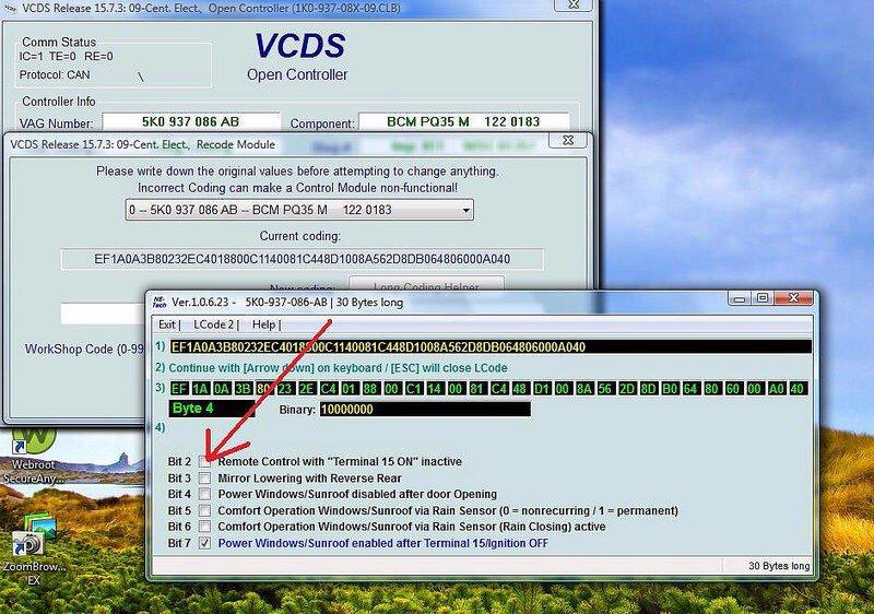

            • Just found this picture from another thread that shows a completely different byte for changing the auto rain close. Is this from a different or older vehicle or is the reason I can't get mine to work because I've not checked the boxes? I've done byte 00 bit 1 and 2 just like the instructions.
              2015 Golf R. Lapiz Blue.
              • ^^^ Reedy : I do admire your persistence in trying to get the auto Rainclose tweak to work!
                Unfortunately, the master control module in your screen shot (the BCM 5K0-937-086) was installed in non - MQB platform vehicles. The mk7 was the first Golf to use this platform and a number of fundamental changes were made to the control modules in this car to cater for new innovations and basic changes in the network structure of the various CAN buses.
                This is a long way of saying that mk7s don't have the screen shot in your post - alas, so you can't access that particular long-coding-helper screen on your car

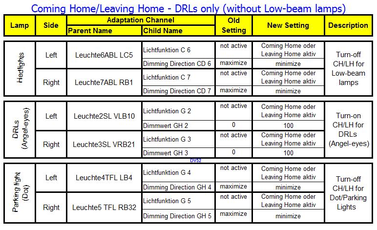

                          Anyhow - instead of me suggesting an answer, I have borrowed the instructions from the tweak
                          For ease of reference, I enclose the table below which is taken from the link:
                          Instructions: DRL only for Coming Home/Leaving Home (without Low-beam lamps)
                          1. Select 09 - Central Elect. control module
                          2. Select Security Access - 16 from the "Open Controller" screen
                          3. Enter the magic number 31347 and return to the "Open Controller" screen
                          4. Select Adaptation - 10 from the "Open Controller" screen
                          5. From the pull-down button check that the default values for the adaptation channels are as shown in the table below for the OLD SETTING column (use the "Search" box to locate the correct channels)
                          6. Only if the check in (5) above is successful, change the values for the adaptation channels as depicted in the table below in the NEW SETTING column (use the "Search" box to locate the correct channels)
                          The tweak instructions are for a North-American-Region vehicle (not our Rest-of-Word model), but this doesn't matter. Simply use the LAMP column to select which lights you want to alter. For example, you can elect to retain the center-dots involvement in CH/LH function by not making changes to Leuchte4FL LB4 and Leuchte5FL RB32 channels - it's entirely your choice!
                          It's of course an untested tweak, but my reading of the instructions is that they appear to be compatible with your request.
                          Good luck and please provide feedback if you try the tweak - that's how the forum community in general (and me in particular) learns stuff!

                            • Originally posted by DV52 View Post
                              Ringo: My bad- I wasn't aware that you had a Clubsport mk7 or its options (strange that your car has the sophistication of HIDs and the leveling mechanism, but it doesn't have fogs- but then the boffins at VW do some strange things).
                              Anyhow - instead of me suggesting an answer, I have borrowed the instructions from the tweak HERE
                              The tweak instructions are for a North-American-Region vehicle (not our Rest-of-Word model), but this doesn't matter. Simply use the LAMP column to select which lights you want to alter. For example, you can elect to retain the center-dots involvement in CH/LH function by not making changes to Leuchte9FL RB2 and Leuchte8FL LB39 channels - it's entirely your choice!
                              Don
                              Wow that's a serious tweak! I'll try to find the time and do it over the coming days and report back.
                              The fog lights get deleted on the Clubsport because of the aerodynamic design of the front bumper. Where the standard GTI has fog lights, the Clubsport has these so called air curtains that divert the air around the front wheels. That doesn't mean there are no boffins in general in VW...
                              Personally I quite like it as its both a sportier look and I hate it when different types of lights (with different color temp) are installed at the front or rear of any car, it almost looks aftermarket to me. And I doubt fog lights would offer any extra benefit than the DRL's already do under foggy conditions.
                              • Ok, so I tried it yesterday. I basically only messed with the first two low beam channels Leuchte6ABL and 7ABL (the dot LED and U leds were already part of the CH/LH function and I wanted it to stay that way). Worked as expected: Headlights now stay off every time I unlock the car, only the U and dot leds are illuminating, job done!
