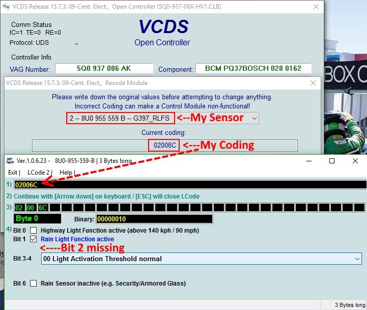

    Ciao Don after installing the rain / light sensor (8U0 955 559 B) I would like to activate the feature, however, did not automatically closed in case of rain in my BCM voice can select the Bit 2 in Byte 0, could you tell me how to activate any further voice to be able to close the windows automatically?
    I'll put screenshot of my VCDS.

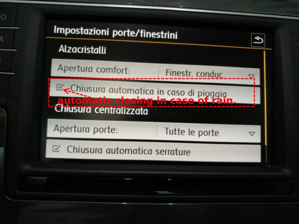

    Setting in my infotainment.
    Your photo of the setting found on the web.
    [ATTACH=CONFIG]28418[/ATTACH]
    I should also delay ignition car lights could you tell me the coding to be done via VCDS?

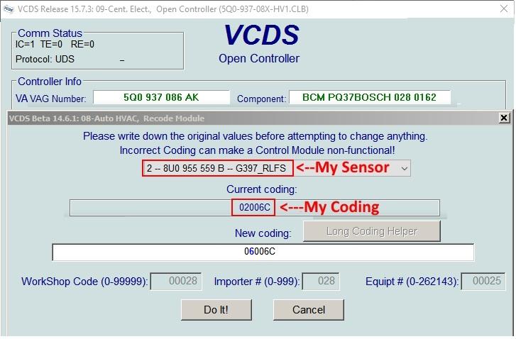

    Fabromix: As I said in a previous response Rain auto-close tweak is very difficult to get working on a mk7 - but if you want to persist with the attempt to implement the function (good luck), then you could try the following:
    If you re-look at the code for your new RLFS, you will see that Byte 0 has a value of hex02 (this is confirmed by the screen shot of Byte 0 in your post). If you had the missing Bit 2 in Byte 0 in your screen and you placed a tick in the box, you would add +4 to the hex value. This would make Byte 0 = hex06 (as per my screen shot from the web).
    So - All you have to do is to use the "Open Controller" screen in VCDS and don't select "Long Coding Helper". Simply copy the value in the Current coding box onto the clipboard and paste this value into the New coding box. Then change the 2 to 6 and press doit!. It's that easy - see the picture below:
    As for your second question - I don't understand what you mean by "delay ignition car lights"
    Don

    • Thanks for help Don unfortunately also by entering your coding do not you see the Bit 2 can be selected.
      I can confirm the proper functioning of the closure in case of rain.

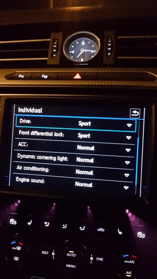

      • Im about 90% of my way through translating the central electrics computer into English.
        Has anyone else tried to do this with any of the others?
        I also adapted a cool feature into the individual driver mode selection.
        But I like it in green better

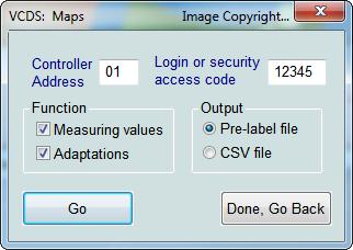

                  So, if you still want help - please make an adaptation channel map of your BCM. For ease of analysis, I prefer that your admap has a .CSV format (and it doesn't matter for this purpose if you include the security code, or not).

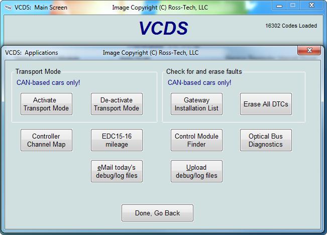

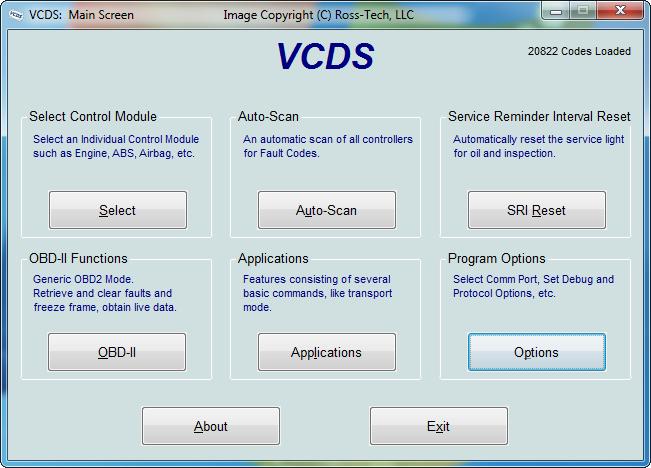

                  So on the screen below, select Applications:
                  On the screen below, select Controller Channel Map:
                  On the screen below, select :
                  Controller Address 09
                  tick only Adaptations (measuring values un-ticked)
                  Log in or security access code leave blank
                  Select CSV file radio button
                  Press GO
                  When the process is completed, look in the C:/Ross Tech/VCDS/Logs directory of a file name admap-09-5Q0-937-086.CSV. Copy this file to a hosting site (like dropbox) and include a link in this thread
                  Don

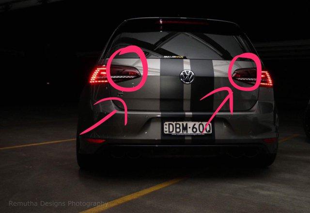

                                daniel: Hi. Are you referring to the section of the tails that I have highlighted in the picture below?
                                If so, then these two LED clusters in each fitting are wired together on both the sides of the car and it is controlled by the Leuchte-set Leuchte27NSL RC6.
                                If you want to operate these LEDs as parking lights then try the following:
                                (1)-Leuchte27NSL RC6-Lasttyp 27 32 - allgemeine LED bis 12W
                                (2)-Leuchte27NSL RC6-Lampendefektbitposition 27 1A
                                (3)-Leuchte27NSL RC6-Fehlerort mittleres Byte DTC-DFCC 27 2A
                                (4)-Leuchte27NSL RC6-Lichtfunktion A 27 Standlicht allgemein (Schlusslicht; Positionslicht; Begrenzungslicht)
                                (5)-Leuchte27NSL RC6-Lichtfunktion B 27 not active
                                (6)-Leuchte27NSL RC6-Dimmwert AB 27 10
                                (7)-Leuchte27NSL RC6-Lichtansteuerung HD AB 27 only_if_closed
                                Note: I've shown the illumination level (i.e. Dimmwert value) as 10 because this is the factory setting on an Aussie R. But you can select any value for the illumination that you want.
