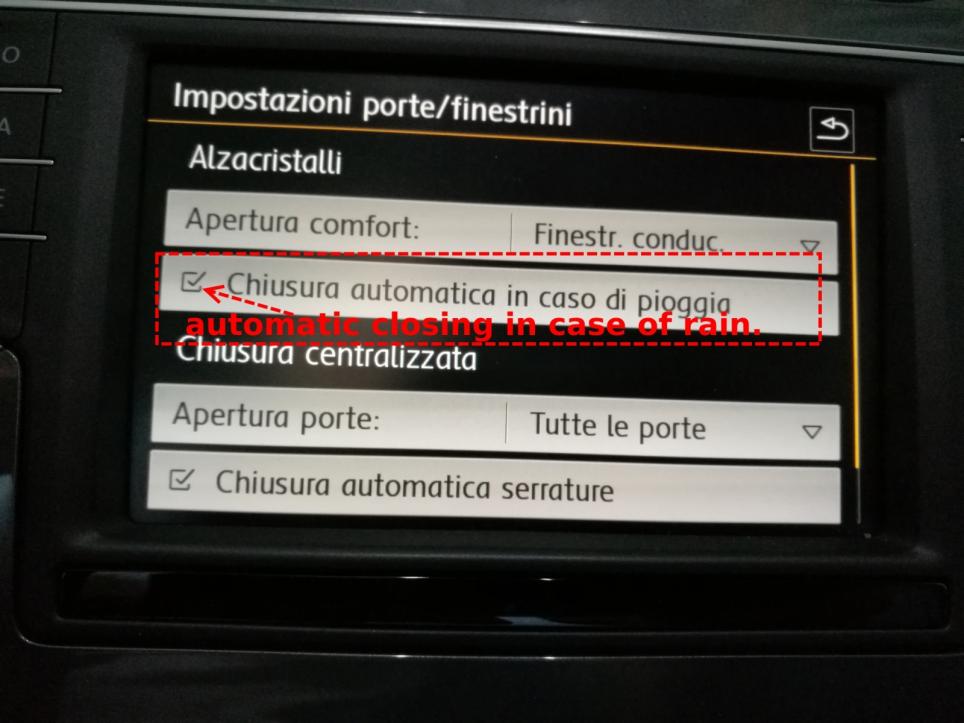

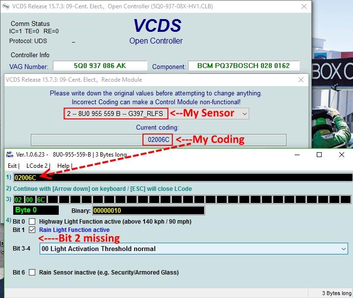

                              • Ciao Don after installing the rain / light sensor (8U0 955 559 B) I would like to activate the feature, however, did not automatically closed in case of rain in my BCM voice can select the Bit 2 in Byte 0, could you tell me how to activate any further voice to be able to close the windows automatically?
                                I'll put screenshot of my VCDS.
                                Setting in my infotainment.
                                Your photo of the setting found on the web.
                                I should also delay ignition car lights could you tell me the coding to be done via VCDS?
