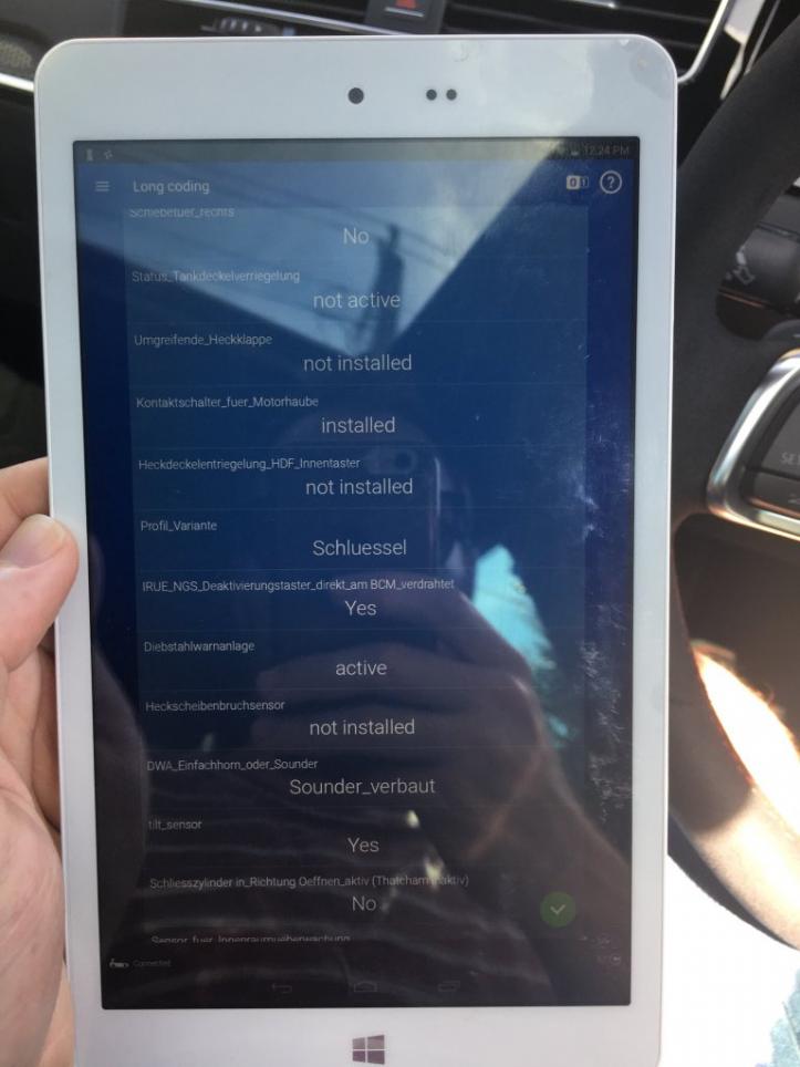

        Hey Don. For the life of me can't get to this screen your showing?
        Where do I go?
        I've select central electronics and then coding but everything's in German. Even tho it's in English for the settings. I can't see any bytes for anything.

        • Ok found it and it was set to activated.
          Then set it to not activated.
          Did nothing.

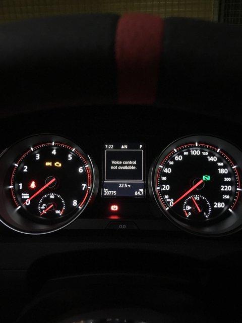

              Yeah ok so I tried that and nothing changed still get the error message.
              Once I made it deactivated this error has now gone but still get the top message.
              This is after the MIB reset as well.

              • Does it look like I'm out of luck?
                GOLF GTI MY11 ADIDAS Candy White, Sunroof
                GOLF GTI 40th ED, White with Sunroof
                • Originally posted by Bassik View Post
                  Bassik- I never like to give-up without a solution, but I'm running out of options.
                  I'm trying to understand why this problem has arisen on your car? The fact that the default value for Byte 24 was set is unusual for a mk7 that came factory fitted without VC. Plus, I consider myself to be fairly active in the mk7 forums and your problem is relatively unique. What's the history of the car?
