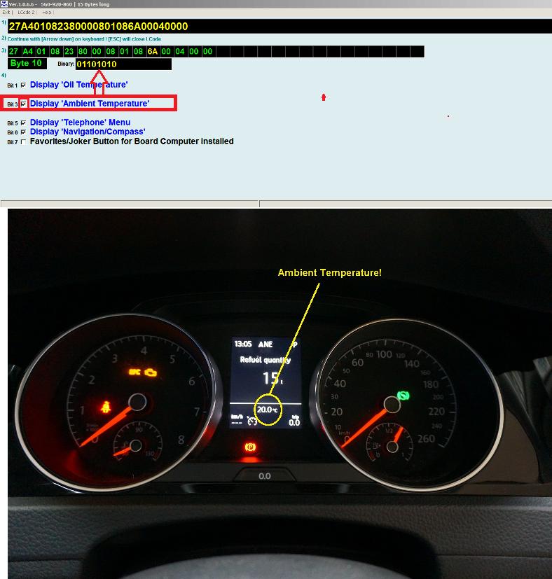

          • Originally posted by alanzidane View Post
            1. Refuel Quantity
            17 Instrument- Coding Byte 10 Bit 4
            I can see there in first image "Display ambient temperature"
            Is it possible to turn that on? How?
            Where does it shows, in the central painel or in that small digital panel behind the wheel between speed/rpm?
            • Originally posted by gaucho View Post
              Where does it shows, in the central panel or in that small digital panel behind the wheel between speed/rpm?
              Gaucho: Hi
              To turn-on "Display ambient temperature" place a tick in the Bit 3 box. When you do this the descriptor "Display 'Ambient temperature'" turns blue in color and a "1" appears in the Binary box in the position that I have shown with an arrow (see picture below) The hexadecimal value of Byte 10 will also increase by 8.
              When the facility is activated, the temperate is shown in the part that I have circled in the picture below (i.e. 20.0 C)
              Don

                      • Originally posted by DV52 View Post
                        Gaucho: Hi
                        Don
                        thnk you! my car came from factory with that temperature displayed there... I thought it was the outside temperature because it's always the same as in the central console.. is that wrong?
