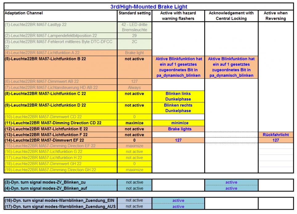

    I've always found the 3rd brake light to be a much undervalued facility on a car. Truth is that on a mk7, it can be used to do all sorts of additional functions (other than just being a brake light). On my highline, the third brake light was factory fitted with an LED.
    Here's some options for how the role of the 3rd brake light can be expanded. I discovered these instructions as part of material that I received from a forum colleague (Many thanks - Morde), who resides in Germany and therefore has access to a richer information base than us English folk (and he understand the German language- which is a great attribute to have when trying to decipher VW's cryptic nomenclature)!
    Note: for the three tweaks shown below, the structure of the changes across the Leuchte-set channels (and the non-Leuchte set channels) are arranged so that each individual tweak is independent of the other options. Pick-and-choose whichever tweak that you like (or choose none!),
    I implemented all three options on my car this morning and I can vouch that they all work
    Cheers
    Don
    3rd/High-Mounted Brake Light Tweaks - Instructions
    1. Select 09 - Central Electr control module
    2. Select Security Access - 16 from the "Open Controller" screen
    3. Enter the magic number 31347 and return to the "Open Controller" screen
    4. Select Adaptation - 10 from the "Open Controller" screen
    5. From the pull-down button check that the default settings for the adaptation channels shown in the table below are as indicated in the Standard setting column
    6. For the wanted options, change the adaptation channels depicted in the table below to the values in the appropriate column (tip: use the "Search" box to locate the channels)

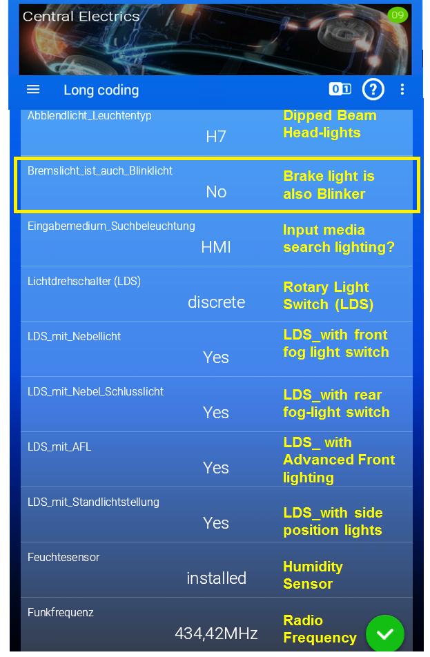

          I've had a quick look through your Leuchte-sets and I don't believe that the continued operation of the brake function on the turn signal lamps is due to any of the settings for the Leuchte channels.
          Rather, I suspect that the solution lies in the code-string for the BCM (not in the adaptation channels in the BCM). However, I fear that VCDS will be of little help in solving this problem! Don't get me wrong, I think that VCDS is a most excellent tool, but (for some reason) there are many Byte/Bits in the long coding helper screens missing their function descriptions.
          Nevertheless, I can suggest a way forward - if you can get access to an OBDeleven dongle. Not sure if you are familiar with this device, but I wrote a explanation HERE which may be of interest.
          OBD11 handles "long coding" a little different to VCDS, but it appears to be more informative when identifying the function of Byte/Bts for control modules. Unfortunately though, the screens that OBD11 uses for the "long coding" descriptors, don't identify the Byte/Bit numbers (i.e. there are no "tick boxes" next to the Bits as per the long coding helper screens in VCDS).
          So - I suspect that the way to solve your problem is to disable the Btye/Bit that I have surrounded in the yellow box in the screen shot below, which is from the "long coding" part of OBD11. I suspect on your mk7, the entry for this Byte/Bit is Yes (on my RoW car, the entry is "No"). Alas, as you can see there is no Byte/Bit number on the picture to translate to the long-coding screens on VCDS!
          You might even consider buying an OBD11 device - they aren't that expensive!
          Don
          EDIT: Whilst I still think that the process outlined above is the proper way of fixing your problem - if you aren't able to access an OBD11 dongle, perhaps it might be possible to "neutralize" the boxed Byte/Bit setting in the screen-shot above?
          This is an entirely untested suggestion, but if you include the Leuchte command for the Brake-light into the 2 x Leuchte-sets for the blinkers and you attach a dimming level of zero to this command - perhaps this will counter the effect of the coding Byte/Bit. Not sure, but it's a simple change - so worth a try (I think)

            • Hi Don and thank you for your kind Norwegian welcome to me I was very happy when I saw it was you who answered my request to the forum because I have seen so many good and well documented answers and advices from you.
              I agree about your assessment regarding decoding code string in VCDS and I will order the OBD11 asap and follow your suggestion.
              I also tried your alternative suggestion today: dimming level "0" for brake light in the leuchte set for blinkers and that almost solved my case, but still there is a little short flash in the blinker (0,3 sec) so I will go for your OBD11 advice and report result back to you.
              Thank's again.
