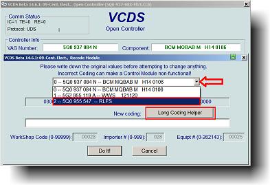

          3. When the screen below opens, click on the pull-down down tab in the middle of the screen (as shown next to the red arrow). As indicated in the picture, the BCM (Body Control Module) has two "slave" modules, one of which is the RLFS
          4, Select RLFS and click on the Long Coding Helper tab.
          Note 1: on some mk7 vehicles, the slave module will be RLS, or RLHS

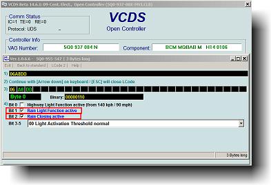

          5. Select Byte 0 and place a tick in Bit 1 and Bit 2 as shown in the picture below. Exit this screen

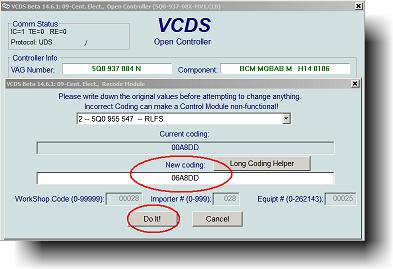

          6. When the screen below appears, ensure that the New coding box contains the Hexadecimal value 06A8DD Click the Do it! tab. Go back to the open controller screen
          Note 2: some forums report "error 31" message at this point. If this error message appears, manually enter 06A8DD into the New coding box instead of using the Long Coding Helper. Then click the Do it! tab
          Note 3: On some mk7 vehicles, the default coding string for the rain sensor is 01E8DD. If this is the case, the required hexadecimal value in the new coding box is 07E8DD.

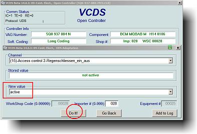

            9. When the Open Controller screen re-appears, click Adaptation - 10
            10 . From the pull-down channel menu, select (15)-Access control 2-Regenschliessen_ein_aus. and select active in New value box. Click Do it! tab

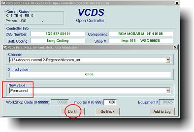

            11. Select (16)-Access control 2-Regenschliessen_art and select Permanent in New value box. Click Do it! tab
            12. Select (28 )-Access control 2-Menuesteuerung Regenschliessen and select active in New value box. Click Do it! tab.
