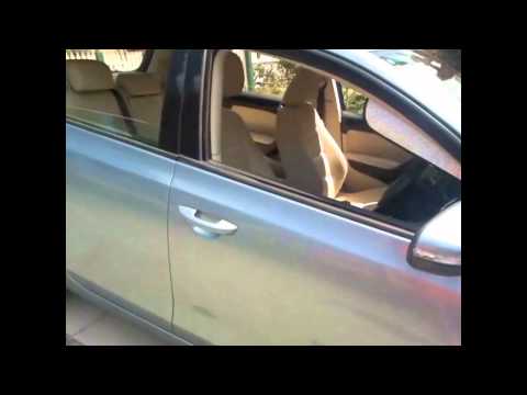

                      Just to address that specific scenario, the windows only close automatically when:
                      (1) You've enabled the feature in VCDS and in the car menu
                      (2) The car is off
                      (3) The doors are locked
                      (4) The wiper stalk is in the Automatic position
                      (5) The Rain/Light Sensor (RLS) detects rain OR if x hours pass with no rain or no-one interacts with the car. Usually this occurs overnight in my experience.

                        I have carried out all the mods for rain closing on my 2013 GT mk7 Golf and still it does not close the windows when wet.
                        Does anyone know why, as Ross Tech are unable to help?

                          Bloggo: I've been reading about this tweak for some time on the overseas forums. I haven't tried the tweak myself because of conflicting reports made by some folk regarding the (in)ability of the Ross-tech cable to program the "RLFS" (Rain-Light-?-Sensor) unit on the MQB platform. Quite a few forums have made the claim that the only way to program the RLFS unit is via a VCP (VagCanPro) at the moment (i.e. not via Mr Ross's cable). I know nothing at all about VCP units, so I can't comment on this assertion. Also, I don't claim to be an expert on Mr Ross's cable (compared to the awsome expertise of some on VWW). However, purely as an exercise in logic are you using the latest VCDS software? You might try loading the latest Beta SW version and then trying again (in the hope that Mr Ross has updated his latest software to be more compliant with the MQB platform)
                          As I said, there are many conflicting statements made about this tweak as some have said that the tweak has worked on their Mk7 vehicles.

                            Hello DV52, I have the latest software, I have tried beta and still I am unable to get this working. I have seen the reference to VCP but this would mean buying another unit, which is not economical. I am at a loss to understand why VCP can do this yet VCDS can't. I am rather disappointed that VCDS does not work and Ross Tech do not appear to have an answer. I have also noticed that when downloading the adaptation files there are many lines truncated in certain modules.

                                Bloggo:Thanks for the information. The Ross-Tech posts pretty much confirm the reports that I had read on the European forums (about the VCDS cable's inability to re-code the RLFS on the MQB platform). I guess (hope) that it's just a teething problem with the new-ness of the mkVII chasis. To quote a famous BBC TV series- "in the fullness of time", I'm sure that this issue will be resolved. Until them, I reckon that we will both have to wind-up the car windows manually when it rains!
