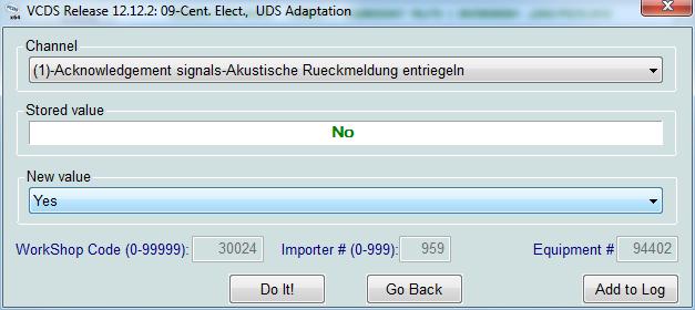

I have it enabled on my Mk6 GTI (love the feature, very handy), and it's definitely being emitted by the alarm chirper, and not the car horn.2008 MkV Volkswagen Golf R32 DSG
AdamD: Thanks for the confirmation. Looks like this is a feature that I will not have on my mk7.Originally posted by AdamD View PostI have it enabled on my Mk6 GTI (love the feature, very handy), and it's definitely being emitted by the alarm chirper, and not the car horn.Please don't PM to ask questions about coding, or vehicle repairs. The better place to deal with these matters is in the forum proper. That way you get the benefit of the wider expertise of other forum members! Thank you.

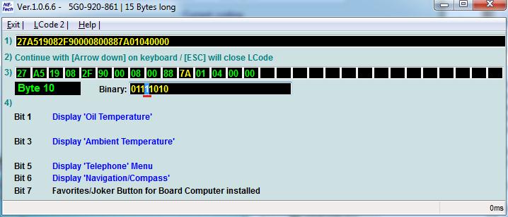

1. Refuel Quantity
17 Instrument- Coding Byte 10 Bit 4

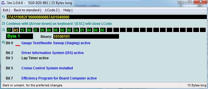

2. Instrument Staging
17 Instrument- Coding Byte1 Bit0

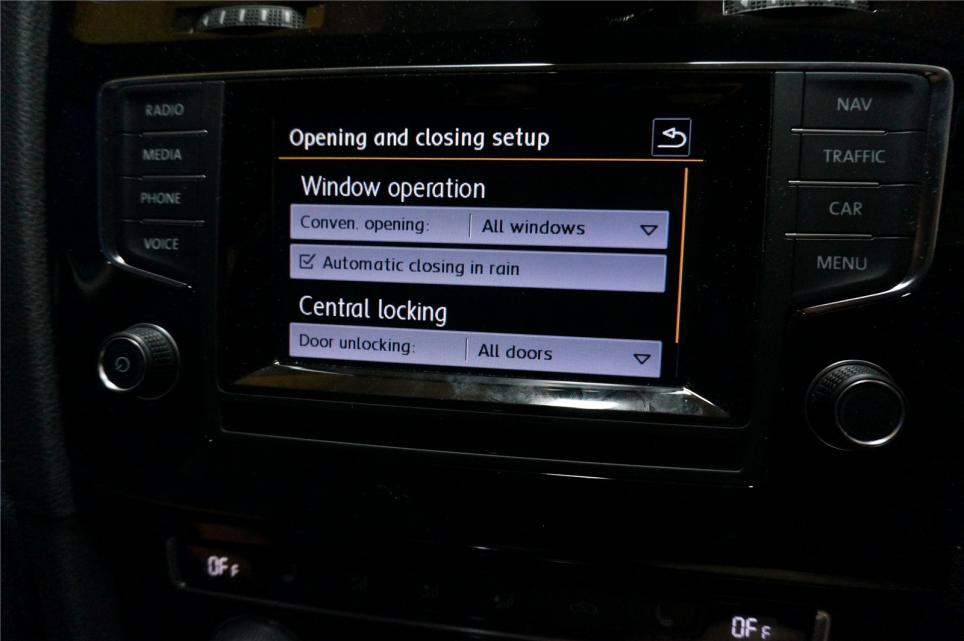

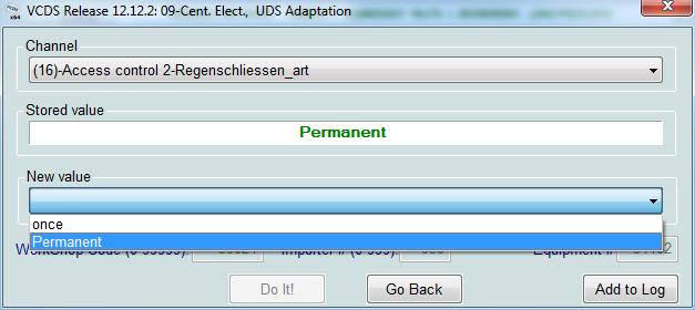

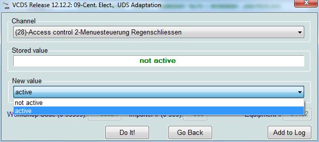

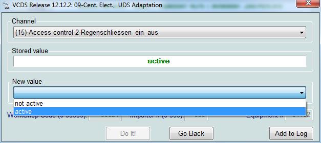

3. Rain Close
09-Cent Elect, Security Access:31347, Adaption

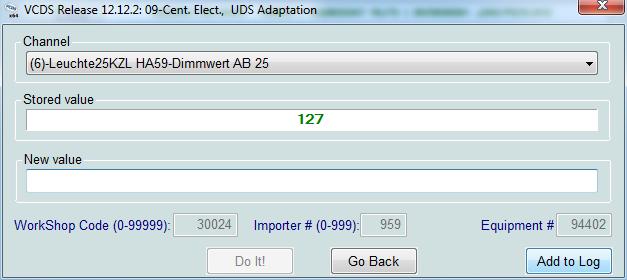

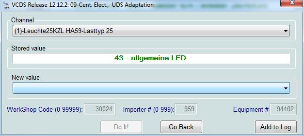

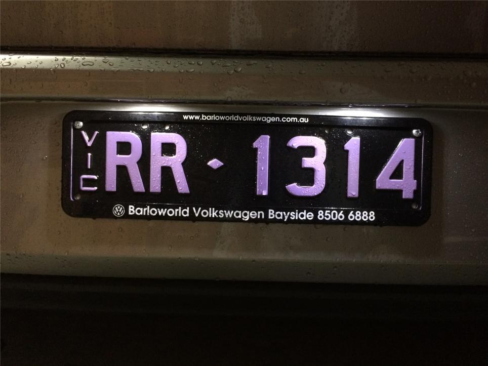

4. LED Number Plate Light

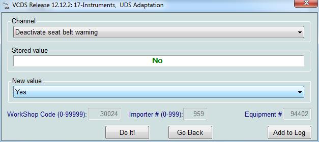

6. Deactivate seat belt warning
17 Instrument- Adaption

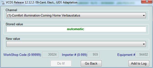

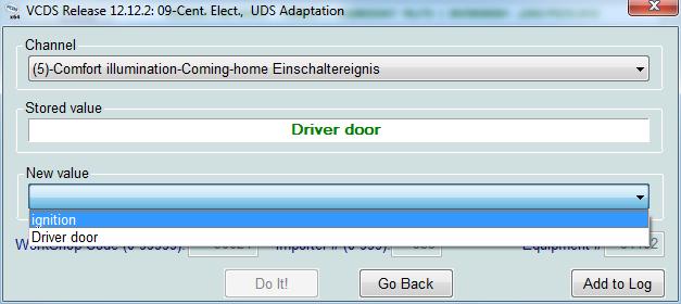

7. Automatic coming home/Coming home light/Coming home timer starting point
8. Beep when unlock/lock.(if you have alarm fitted)

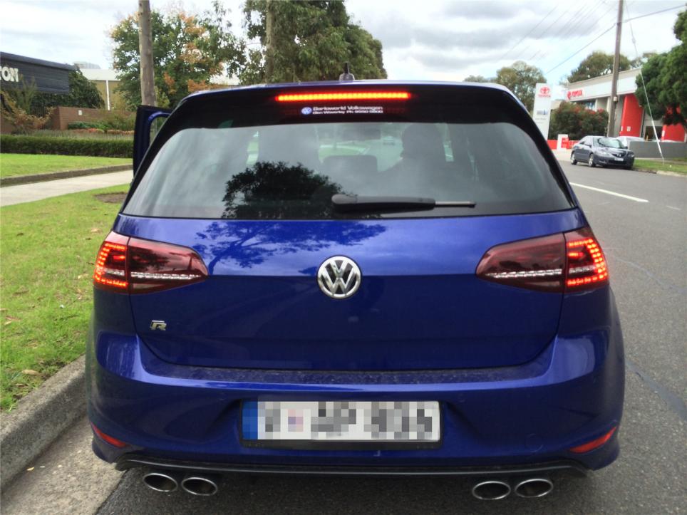

9. Full brake light if you have LED tail light(GTI Performance OR R)
I lost the screen shot to show your guys. Here is the photos to compare before and after. I'll post the screen shot later on.
