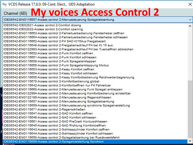

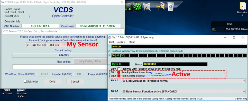

                  • Hello community, I ask if any of you would help me to find the items to activate the automatic closing of the windows in case of rain in a Golf MK7 2013.
                    I have performed the procedure of DV52 (Link: VCDS (VAG-COM) codes and programmable options for Golf Mk7) that in the first items everything is ok while as I enter Codink I can not find the entries:
                    So far everything is ok.
                    From here on I can not find the rumors:
                    -Access control 2-Regenschliessen_ein_aus.
                    -Access control 2-Regenschliessen_art
                    These are my entries in Access Control 2:
                    Thank You!!!
