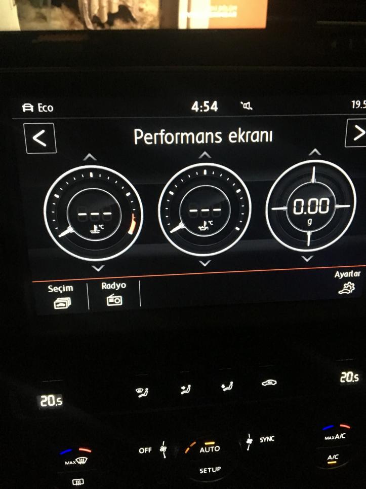

                        • Discover pro mib 2 Sport Gauges Oil and Water temp
                          Hello to everyone
                          I know that this issue has been opened many times but my question is different. My car is 2014 golf 7 gti and l install to my car cracked Discover pro mib 2. The Mib2 is fully functional, including sports gauges(boost,g sensor and kw) in my car. But the sports gauges and the off-road gauges do not get information about oil and water temperature. How can I get information for oil and water temp?
                          • l have discover pro mib 2 and l activated the off road display but mib 2 cant get the information of water and oil temperature. Anyone knows how can l get the info about temperature?

                              • l did the same way but oil and water dont working on sport and off-rode mode
