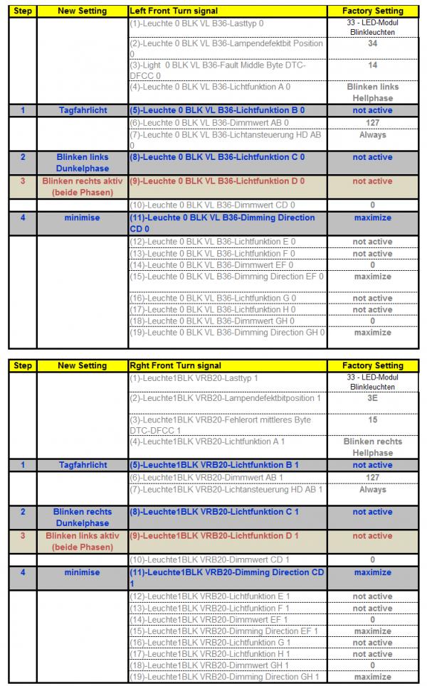

            • Just a quick query, has anyone been able to code the Front LED Indicators on a 7R to permanently stay on during the day along side the DRL? ive seen many youtube videos that have 7R's rolling with that enabled. would love to get it done to mine, providing i dont get done by the Po Po's
              15 Golf R MK7
              Manual
              APR Tuned
              • Originally posted by mrmomoz View Post
                mrmomoz: In a remarkable coincidence of happenstance (how's that for a tautology?) - our mutual forum colleague anonymus included the answer to your question a couple of posts back.
                Here's a copy of his/her inclusion:
                Don
                • Originally posted by DV52 View Post
                  Don
                  Keep in mind that your front hazard light will not work with the coding. I will have to give it another go on the weekend with a different logic that I have in mind and see if I can get it working.
                  Kim
                  • annonymous : Just remove the Blinken links aktiv (beide Phasen) and Blinken rechts aktiv (beide Phasen) commands (i.e. step 3 in each table
                    Don
                      Don
                      Don : At the other end, I would like to have that feature when indicating.
                      I am thinking to move step 1 to G0 and Aktive Blinkfunktion hat ein auf 1 gesetztes zugeordnetes Bit in pa_dynamisch_blinken to H0 and leave all the others in place. But not too sure about dimmwert and dimming direction settings.
                      Kim
                      • Originally posted by anonymous View Post
                        Don :
                        Kim
                        Kim: Arrh........... I see - good thinking!!!
                        I like the "Aktive Blinkfunktion hat ein auf 1 gesetztes zugeordnetes Bit in pa_dynamisch_blinken to H0" suggestion. But for hazard flashing you will need to also activate Dyn. turn signal modes-Warnblinken_Zuendung_AUS and Dyn. turn signal modes-Warnblinken_Zuendung_EIN Then, just finish-off by setting Dimmwert GH 0 to 127 and leave Dimming Direction GH 0 set to maximize (of course the same changes are needed to the right-side light)
                        But I'm not sure about moving step 1 to G0 (because it gives the DRL command a higher priority than DRL Wink - so DRL Wink won't ever function). Perhaps try the changes above first - then see if the DRL function really needs modifying
                        Don
                          Don
                          Don - based on my quick coding session last weekend , "Aktive Blinkfunktion hat ein auf 1 gesetztes zugeordnetes Bit in pa_dynamisch_blinken" would not work on its own. My guess is that it has to be paired with another function to work. eg - if you revisit the pace car indicator on hazard light coding only post.
                          I've tried your suggestion with Flashing DRL on LOCK/UNLOCK but no luck(I might have done something wrong). That why I am guessing that it might need pairing. Won't be able to try again until weekend to see if it works. I will try your suggestion too. It's all part of learning and trying to understand the whole logic behind it
                            Kim:In my experience - Yes and No!! Yes - "Aktive Blinkfunktion hat ein auf 1 gesetztes zugeordnetes Bit in pa_dynamisch_blinken" does need to operate in tandem with another function. No - no "pairing" needed!
                            My understanding is that this Leuchte command only operates within the context of Dynamic Turn Signal functions - so the command won't do anything unless the Dyn. turn signal modes adaptation adaptation channel is activated (in later model BCMs, these functions are grouped under the "parent" channel name "Außenlicht_Blinker").
                            But by all means, experiment with the Leuchte command and share your observations
                            I implemented the tweak on my mk7 before posting the instructions here - works OK for me!

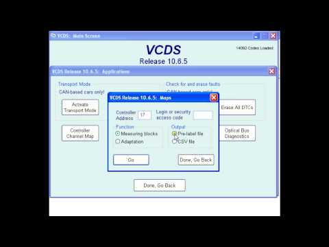

                                OK: Not sure that I entirely understand the problem, but I'm guessing that the issue here may be related to the changes that were wrought in later versions of Ross Tech's software. I can't remember the exact SW version number where these changes were first made, but what happened was that the leading bracketed numbers in the adaptation channel descriptors were replaced with what RT calls "tags".
                                So, if you are using the latest Ross Tech Software - and you should be using the latest software, the relevant channel descriptors are:
                                (15)-Access control 2-Regenschliessen_ein_aus =IDE08542-ENG125655-Access control 2-Regenschliessen_ein_aus
                                (16)-Access control 2-Regenschliessen_art=IDE08542-ENG125656-Access control 2-Regenschliessen_art
                                (28 )-Access control 2-Menuesteuerung Regenschliessen = IDE08542-ENG122186-Access control 2-Menuesteuerung Regenschliessen
                                If you still can't find these channels, then make an adaptation channel map of the BCM and load the file on a third party hosting site (like dropbox) - then post a link to the file here and I will have a look at it. If you are not sure how to make an "admap" - this might help:
                                Don
