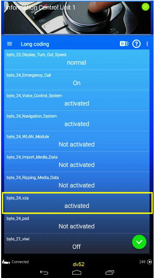

            Rooboy: What's the value of the code-string on your hex5F module - in particular Byte 24, Bit 6?. The software switch to enable Traffic Sign Display (which VW calls VZA) is on this Byte/Bit. Here's the OBD11 screen:
            Note: the screen-shot is from a mk7, not mk7.5
            Don
