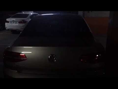

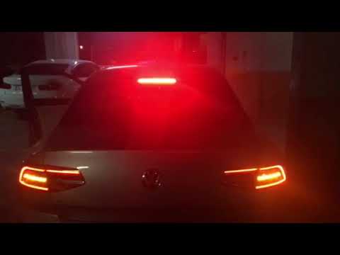

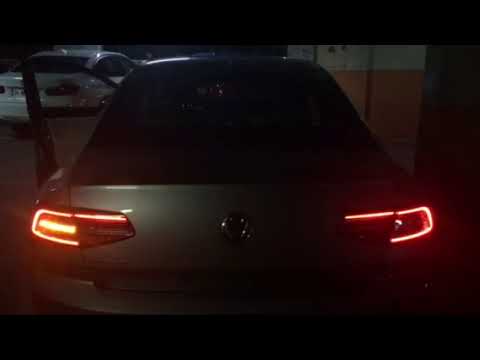

              • Hi Don,
                Here are the numbers for leuchte sets I know.
                If I code all the below lines, I get the the style in video.
                Leuchte 28RFL LC11-Dimmwert GH 28
                Verilecek değer - 100
                Leuchte 28RFL LC11-Lichtfunction H 28
                (Blinken links Dunkelphase)
                Leuchte 29RFL RA64-Dimmwert GH 29
                Leuchte 29RFL RA64-Lichtfunction H 29
                (Blinken rechts Dunkelphase)
                if I code just the Leuchte 28 I get the below.
                The problem is I just want to use this coding when locking and unlocking, but when I signal to left Leuchte 28 lights up both of the lights on each side of the trunk.

                  • Originally posted by Dark975 View Post
                    Hi Don,
                    hmm......... these are very different to the Leutch-sets for the mk7.5s in my database:
                    Leuchte29RFL RA64 = right side reversing light
                    Leuchte28RFL LC11 = Left side reversing light plus left side rear fog light
                    Don
