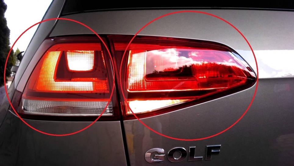

                • Hi,
                  I activated automatic coming home, but can someone say if this behavior that's as it should do?
                  If I exit car without lock the car, all rear lights are on:
                  If I exit car, lock the car, only this rear lights are on, the other one switches off:
                  Pictures are just an example. Please check the rounded marks.
                  Nothing to do with leaving the rotary light switch in the parking light position with the turn-signal stalk in the left turn position
                  I activated automatic coming home lights, instead pull the lights stalk.
                  So my doubt is:
                  When I exit car, coming home is already activated, and rear lights are as picture 1.
                  After that I lock the car the rear lights are as picture 2.
                  Rounded marks = What light is on.
                  Best Regards,
                  Chirag Geiantilal
                  '06 - Volkswagen Passat 3C 2.0 TDI Highline - 2009 - 2017
                  '12 - Volkswagen Golf VII 1.6 TDI Confortline - 2015 - ...
                  • Not sure. I have different tail lights to yours.

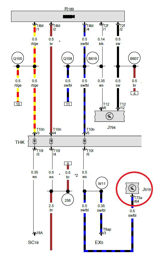

                          • Im having an issue with my Mk7.5 - my reverse camera is staying open (although not displayed on the MFD) and a single reverse light is remaining active whenever the car is on regardless of speed/gear etc. I've run an auto-scan and nothing is showing up to suggest a fault but I'm thinking something may be off coding wise? Can anyone point me in the direction on where the speed threshold for the camera is on the cars coding? Or potentially what triggers it to open? I'm thinking the coding for the reverse light/camera might be off? I don't remember playing with those settings on OBD11 and any stage though.
                            I'd rather try and sort it out myself than going to the hassle of going to the dealer etc.
                            2018 Golf 7.5 110TSi Comfortline | Drivers Assistance Package | Retrofitted: Traffic Jam Assist | Emergency Assist II | Light Assist | OEM Vienna Leather Sports Seats with full Highline Interior | Power Folding Mirrors
                            • Is the rear camera factory fitted or is it fitted after? As after is connected to the reverse light wire. So it could be you've either played with the code for the rear clusters or there a problem with the switch
                              • ^^^^ here is a section of the Wiring diagram for the RVC which is R189:
                                Doesn't matter if you are not familiar with wiring diagrams - the thing to note is the bit that I have circled (i.e. J519) which is what's called the Body Control Module (or the BCM @ address hex09). As shown, the camera has a blue/black wire that is connected to pin #64 on the A connector (i.e. "T73a /64" in the wiring diagram means that the blue/black wire is connected to pin #64 of the 73 x pin connector on the "A" socket) of the BCM. This is the wire that turns ON/OFF the RVC (this pin normally operates whenever the reverse-switch in your gearbox/auto-tranny changes state)
                                Now, there is a Leuchte-set (which is a bunch of adaptation channels) in the BCM called Leuchte29RFL RA64 that controls how/when the right-side reverse light operates. Notice the A64 term in the descriptor - this means that the Leuchte-set controls pin #64 on the A connector of the BCM. Yes, the same pin as on my wiring diagram!!!
                                So- as jap says, the basic problem in your case is probably the way that pin #64 (A connector) is operating. If you are using VCDS, I suggest that you look at your Adplog.CSV file in the lap-top that you use to run VCDS for any recent coding changes that you made to Leuchte29RFL RA64. Very likely, it is this coding change that has forced a voltage to appear on pin #64 (A connector) at an inappropriate time.
                                Don
