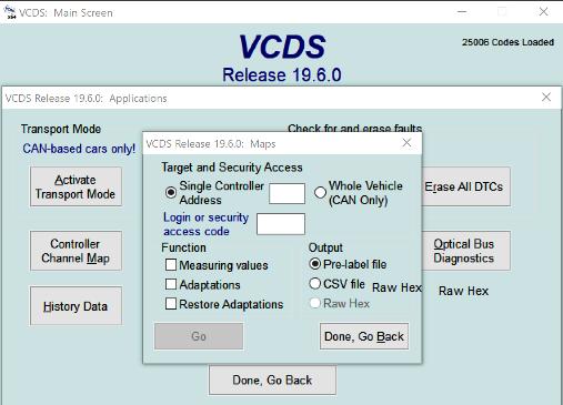

        FIRST - CREATE A DATABASE OF THE CAR'S "VIRGIN" CHANNEL SETTINGS.
        Not surprisingly, the restore procedure needs a reference source of factory settings for each separate vehicle because adaptation channel values vary with individual cars (due in the main to the options fitted).
        To make this database:
        1. From the first VCDS screen, select Applications
        2. From the Applications screen, select Controller Channel Map
        3. The "Maps" dialogue box appears as shown
        4. In the dialogue box - change the settings by entering the relevant details and selecting Adaptations in "Functions" and Raw HEX in "Output". Note: consider using "Whole Vehicle (CAN Only)" - for cars that use CAN-Bus diagnostics
        5. Press the Go button and wait for the procedure to finish.
        6. repeat the process for every control module in the car. Note: modern MQB vehicles can have upward of 6,000 adaptation channels -so the process can take quite a while. Therefore, either use a battery charger or let the engine idle).
        When this procedure completes, VCDS will put a series of new files in the directory C:\Ross-Tech\VCDS\Logs. These files will have the format:
        • apdhex-hex address-module part number_VIN-date(yyyymmdd)-time (hhmm).CSV

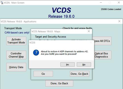

        SECOND - RESTORE ADAPTATION CHANNEL SETTINGS
        3. In the dialogue box - change the settings by entering the module address and make sure that you enter the module security access code. Select Restore Adaptations in "Functions":
        4. Press "Go"
        5. As prompted by VCDS software- navigate and select the correct file in C:\Ross-Tech\VCDS\Logs sub-directory. For the settings in the screenshot above, my file was adphex-42-5Q4-959-593-B_WVWZZZAUZEW015673-20190714-1443.CSV
        6. Select "Yes" at the following screen:

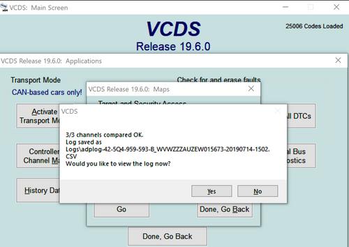

        7. the procedure completes successfully with the last screen below (view the log report if so inspired!):
        That's it - the adaptation channels in the module are reset to the original factory values!!
