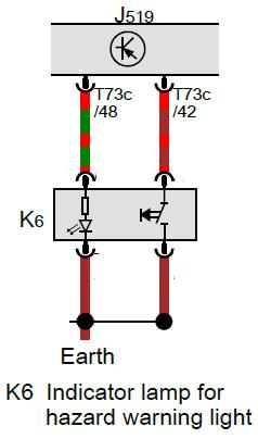

                        • @Hillbilly: clearly I can't dissuade you from believing your suspicions - so I won't try. If you can be swayed by the brutal logic of a wiring diagram, then the arrangement below should be compelling. It shows that the hazard warning light is controlled ONLY by J519 - which is the module that VCDS calls "BCM" and OBD11 calls "Central electrics".
                          As I have said - nothing in the tweak impacts on the hex 17 module (the dashboard/instrument cluster)
                          Don
                          • Originally posted by DV52 View Post
                            Don
                            Yes I believe you and its my own fault for not looking before changing anything. However i have never had the message pop up before. or maybe Ive always had my foot on the brake when I turn car on. Going for a 200k drive tomorrow so will see what happens

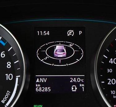

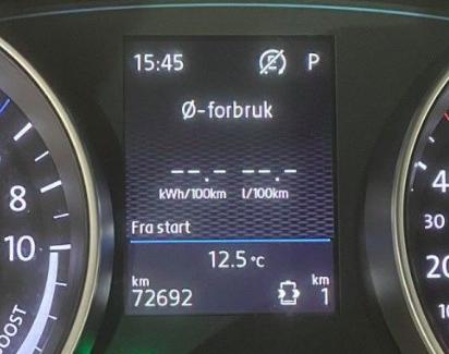

                              • Hope someone can help me with this? Does anyone know how to change this white (the one above temperature) line to blue?
                                Where can I change this with VCDS?
                                White:
                                Blue:
                                Hope anyone can help, thanks!
