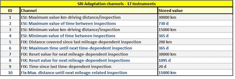

                        If you want to get "more creative" and you want to fiddle with stuff like max/min settings (as you mentioned in your first post), then here are the other settings for the SRI
                        The RT instructions place a "0" in the setting in adaptation channels with ID #5 and ID# 9 (the values in my pic are my current values). I've not played with the Max/Min values, but I suspect that the "FIX" channels are the ones to change and the ESI channels reflect the values in the FIX channels. Let me know if I'm correct-please
                        To access these channels just use the pull down menu in 10-adaptation for control module 17-Instruments.
                        Enjoy!
                        • ESI stands for extended service intervals, known as the "LongLife" service regime and features variable service intervals.
                          FIX refers to fixed service intervals, known as the "Time and Distance" service regime.
                          Vehicles for the Australian market are intended by Volkswagen to be configured for the latter.
