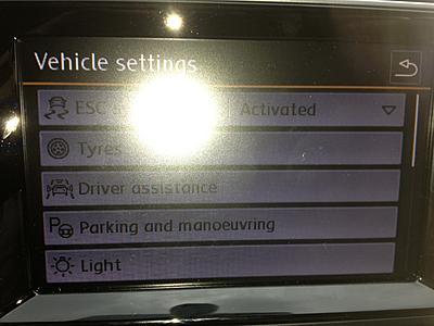

                  • I just got a new Mk7 Golf R on Friday. I have noticed something peculiar on the Car menu/settings sub menu. I don't have either the "Mirrors & Wiper" or "Opening & Closing" Selections in the infotainment menu:
                    They are in Factory Settings though:
                    I have looked at all the coding & adaptation settings in the Central Electronics & Information Electr. modules, can't seem to find it. Looking for some pointers. These were NOT there when I got the vehicle. If someone has some files with these displayed or knows the specific setting, that would be much appreciated.

                    • Originally posted by fontana302 View Post
                      Fontana: First- congratulations! The Golf R is a really fantastic car (I've only driven one for a very short time, but it goes like a cut cat!)!
                      OK. Let's deal with the missing items in the set-up menu. None of the tweaks that you have listed would normally affect these items. Your picture (above) shows only the first part of the set-up menu. Normally, "Mirrors & Wipers" is the setting after "Light" (shown on your pic) and it is followed by "Opening & Closing". But both these items are on the second page of set-up
                      When you slide your finger down the RHS of the screen (pull-down the vertical line shown on your pic on the top RHS), what are the screen settings after "Light"? If the missing items aren't on the second page, take a pic of the next page of the setup screen (i.e. after "Light") and paste it here, so we can see it -please
