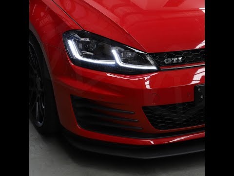

                          • I have a question about what is possible with programming of the all LED headlights?
                            Is it possible to replicate the dynamic style that these Supernova aftermarket units can do on a GTI?
                            MY20 MK7.5 Golf GTI - Tornado Red - LP/S&SP
                            MY19 AW Polo - Comfortline - DAP
                            • Originally posted by genebaby View Post
                              Those arent headlights they are the DRL's and turn indicators
                              There is an OBDII mod called PACE CAR lights for a Mk7 does that with rear indicators I dont know about the fronts
                              Pace Car Indicators - OBDeleven Pro Coding - Volkswagen Golf R - YouTube
                              Mamba Ebike to replace Tiguan
                              • Yes, you're so helpful. They are the DRLs/indicators inside my headlights, and they are LED, hence I was wondering what programming could be done with the LED's in the headlights, these being one subset of them.
                                I am guessing if anyone would know it would be Don, you there buddy?
                                I'm cool with getting aftermarket side indicators for the mirrors but a whole headlight assembly is another thing, considering what I have now. If I had non-LED headlights the Supernova ones would be a no-brainer.
                                I'm new to this world, three months ago I had no idea I'd have two VW's now, but I'm realising that to get some of the features I'm after it would have been easier to have an older car to upgrade. Such is life.
