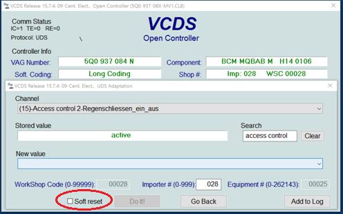

        Can't get the rain closing tweak to work...went thru DV52s guide and tried everything. Just does not work. Mines a my15 R. Other tweaks have worked fine. Very frustrating. Any advice?
        jazzyjames: Sorry to read about your difficulties. It's little solace I know, but you aren't alone in not being able to get this tweak working on a mk7.
        If you still want to persevere, there are some suggestions that I can make, but I stress that these are just guesses that I have put together after chatting with a colleague in Germany (mercifully, my colleague's English is much better than my German)
        Suggestion 1:Ross Tech have made many changes to their software since I wrote the tweak instructions. For example, the current VCDS software version allows the user to perform a "soft reset" of the control module on-the-fly. This facility wasn't available on the version that I used to write-up the tweak (compare the screen shots in my instructions with the picture below).
        What might be worth trying is to reset the BCM after each adaptation channel change (my VCP cable does this as a standard feature). This is done by ticking the "soft reset" box (circled) then Doit! tab - see picture below.
        Suggestion 2: My understanding is that similar problems were experienced with the Skoda Octavia 3, which is also built on the same MQB platform as the mk7 and it used the same RLS/RLHS/RLFS. I'm told by my German colleague that the way that this problem was solved (for the case of the Occy 3) was to only enable Byte 0, Bit 2 (i.e. not activate Byte 0, Bit 1). On the Audi A3 (8V), again which was also built on the MQB platform and again the same RLS/RLHS/RLFS, the tweak worked by using the opposite order of Bits in Byte 0 (i.e. Enable Bit 1, not activate Bit 2)
        You cold try either/both of these permutations
        As I said, these suggestions are long-shots
        Don
        PS: If you try these suggestions, I will include your feedback on the tweak instructions

          I'll certainly give them a go Don and report back [emoji106]
