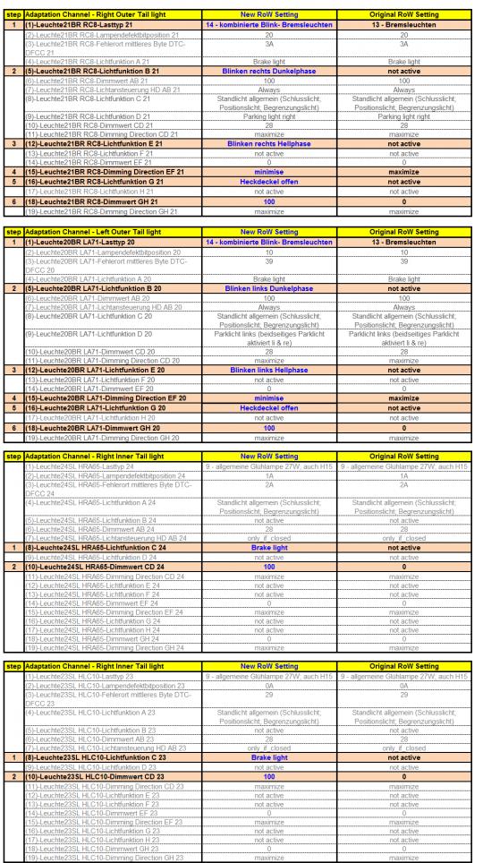

                ODBII Tweak Instructions: DV52-Tails (for incandescent taillight assemblies)
                1. Select 09 - Central Electr control module
                2. Select Security Access - 16 from the "Open Controller" screen
                3. Enter the magic number 31347 and return to the "Open Controller" screen
                4. Select Adaptation - 10 from the "Open Controller" screen
                5. From the pull-down button check that the default settings for the adaptation channels shown in the table below are as indicated in the Original RoW setting column
                6. Only if the default settings are confirmed (in step 5 above), change the four Leuchte channels depicted in the table below to the values in the New RoW Setting column.
                Suggestion: use the new "search" facility on the RT software to find the correct channels
                Notes:
                • This is one of the more complex tweaks because it uses the "Hellphase/Dunkelphase" command in an unusual fashion. In total there are 16 x adaptation channel changes required to implement this tweak.
                • BE CAREFUL SELECTING EACH OF THE ADAPATION CHANNELS AND THE NEW SETTINGS, and double-check that the correct changes are to be made before pressing the Doit! button - please!.
                • If the tweak goes pear-shape, remember that the Codinglog.txt file (which is located in the Ross Tech/Debug subdirectory) is your best friend!!
                • I make no judgement about the compliance (or otherwise) of the lighting arrangement in this tweak with the Australian Design Rules. Anyone contemplating the implementation of this tweak should satisfy themselves in this regard before proceeding

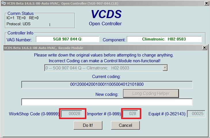

                    • Why do i get this when trying to change the soundaktor?
                      • Originally posted by monkeysrus View Post
                        Monkeysrus: Yes, I reckon that every VCDS cable user has at some time in their experience gotten that screen. It happens usually the first time that you try to make a change to a control module and it simply warns you that the you are trying to add zeros into the Work ShopCode/Importer/Equipment data. Nothing wrong at all. Simply select the "YES" button and let VCDS enter the 12345 sequence numbers.
                        If this doesn't work (and it usually will work), you can always thieve a set of codes from one of the other control modules. I've highlighted where you can find these codes in the picture below
