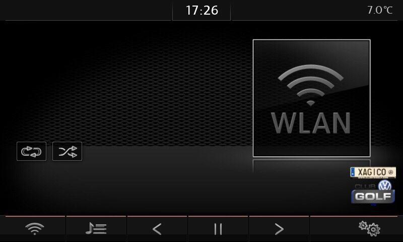

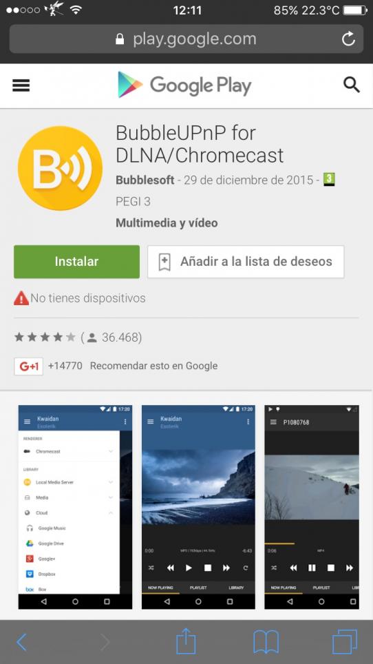

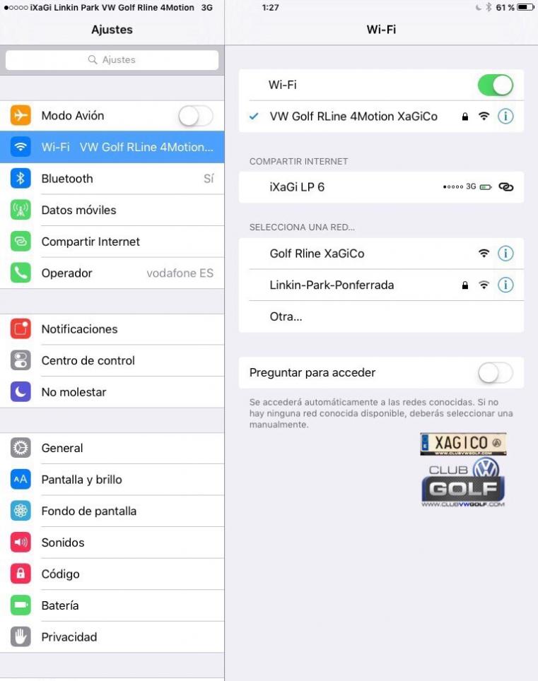

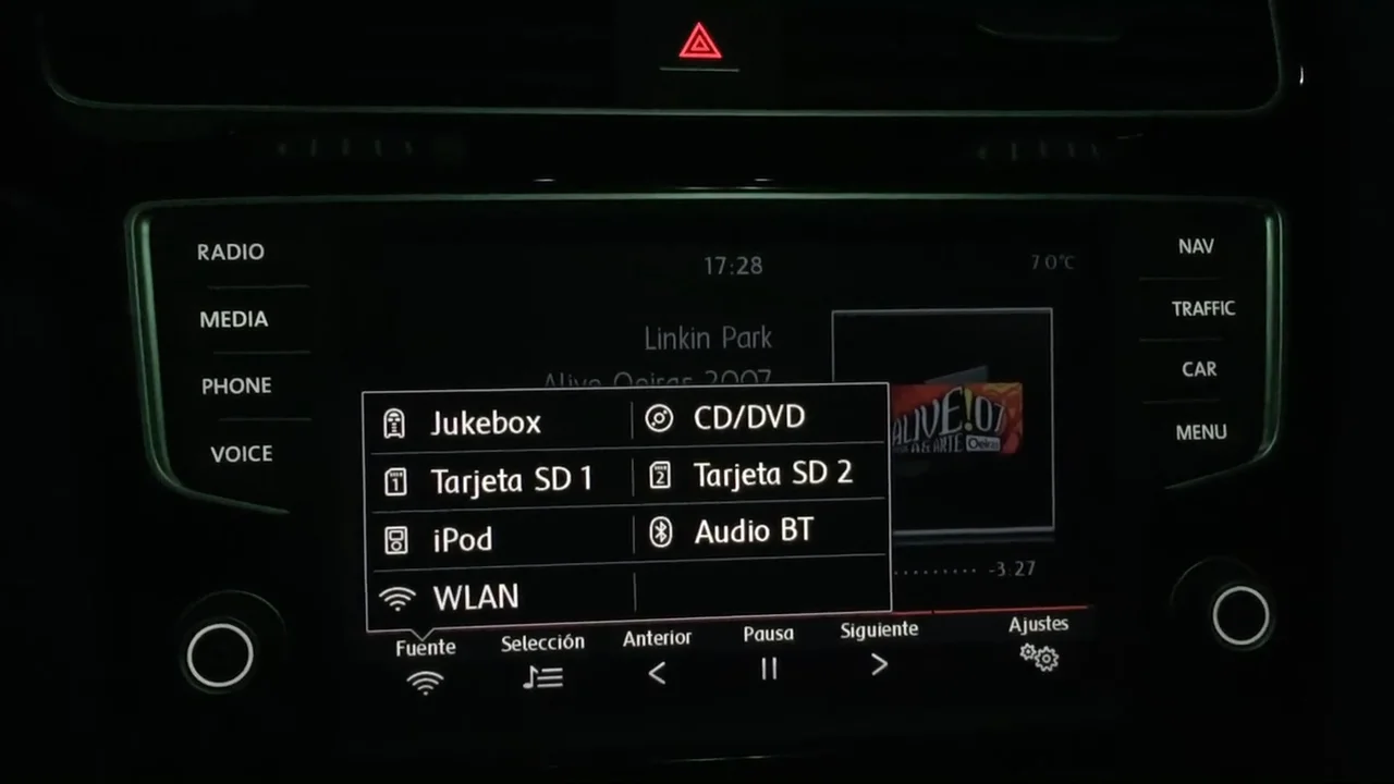

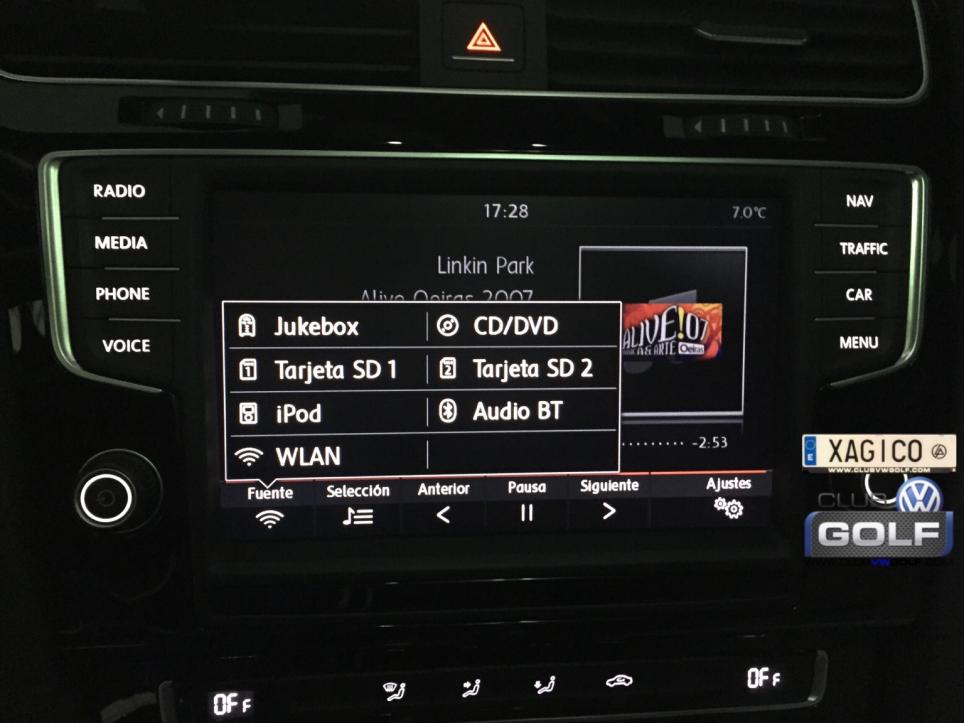

          • Hi!!
            Yeah!!!
            Very Very Thanks @Chillout
            Enabled WLAN access point
            But it leaves an error!
            Example App DNL UPnP Apple:
            Example App DNL UPnP Android:
            Regards and Good Day!
