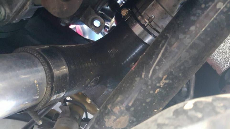

                          • Noticed the PoD got a very loud air leaking noise on the highway the other day
                            It just appeared out of nowhere and after some testing it seems to be boost related
                            After looking from under I found this
                            Looks like the driveshaft is rubbing against the silicon turbo hose

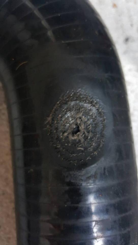

                            Took it out to have a good look and looks like it been through some serious rubbing
                            Plus there was already a not very loud air leak since I took the pipework apart to solve some chafing issues on the MAP sensor

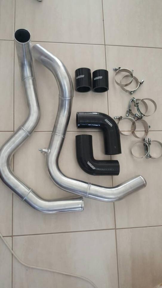

                            So I end up buying the pipework kit from the Darkside guys
                            Took only 4 days including weekend to arrive from the UK that was quick!
