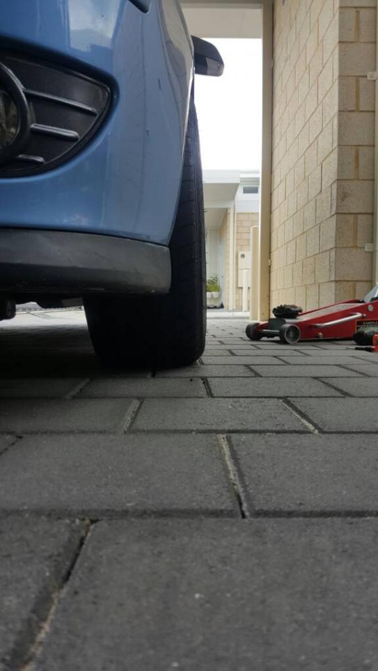

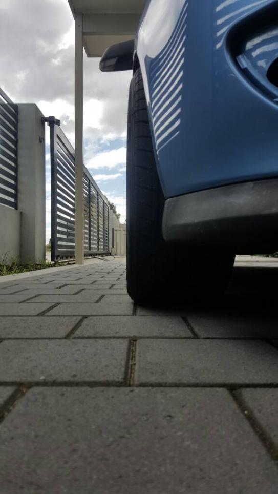

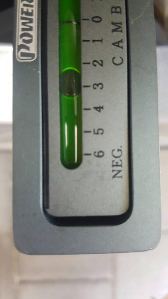

          • Hit a curb on the passenger side pretty hard the other day
            Ended up with almost -3 degree more than the other side
            Went through the bolts and joints on that side and nothing seems loose/off
            LCA, tie rod and drop link seems straight
            Wheel bearing has no extra free play
            Maybe the hit was hard enough to shift the subframe?
            Any ideas guys?
            Setted to zero on driver side
            Passenger side
